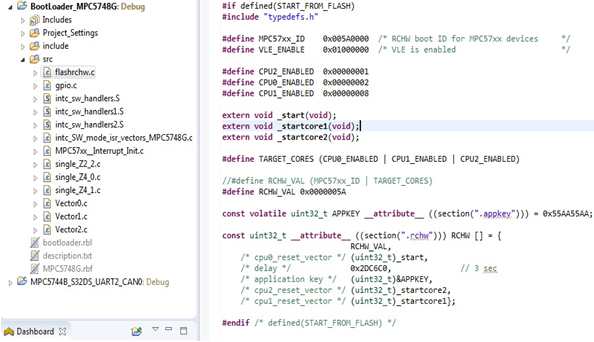

  • Change the “flashchw.c” file by adding the following piece of code:
#if defined(START_FROM_FLASH)
#include "typedefs.h"
#define MPC57xx_ID 0x005A0000 /* RCHW boot ID for MPC57xx devices */
#define VLE_ENABLE 0x01000000 /* VLE is enabled */
#define CPU2_ENABLED 0x00000001
#define CPU0_ENABLED 0x00000002
#define CPU1_ENABLED 0x00000008
extern void _start(void);
extern void _startcore1(void);
extern void _startcore2(void);
#define TARGET_CORES (CPU0_ENABLED | CPU1_ENABLED | CPU2_ENABLED)
//#define RCHW_VAL (MPC57xx_ID | TARGET_CORES)
#define RCHW_VAL 0x005A0000
const volatile uint32_t APPKEY __attribute__ ((section(".appkey"))) = 0x55AA55AA;
const uint32_t __attribute__ ((section(".rchw"))) RCHW [] = {
                                                                        RCHW_VAL,
            /* cpu0_reset_vector */ (uint32_t)_start,
            /* delay */                                            0x2DC6C0,                                          // 3 sec
            /* application key */ (uint32_t)&APPKEY,
            /* cpu2_reset_vector */ (uint32_t)_startcore2,
            /* cpu1_reset_vector */ (uint32_t)_startcore1};
#endif /* defined(START_FROM_FLASH) */

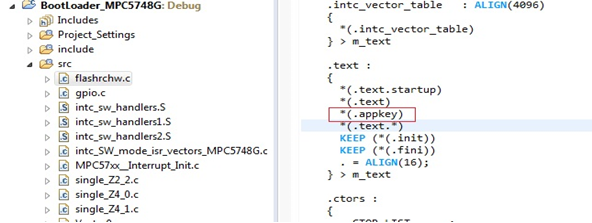

  • Modify the linker file as shown below by adding a new line *(.appKey) into the .text segment:
Figure 6.2.2 

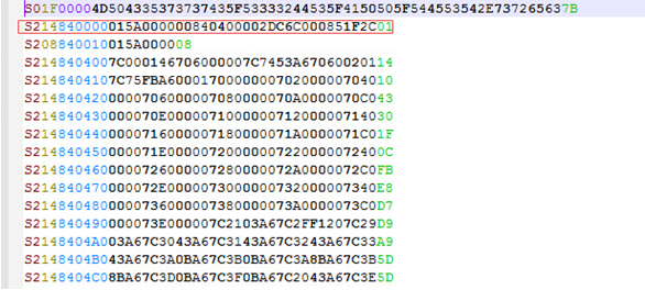

  • The example output .srec file generated by the compiler integrated in S32 Design Studio:
  • The first part of the file:

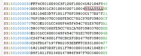

  • The last part of the file:
Figure 6.2.4

Then, I tried to load your code with rappid. As I did before, I loaded rappid bootloader s-record with JTAG. Then, I built your code again and I sent s-record by utility app. However, it did not run and I saw same behaviour.
You added s-record pictures on your response. When I looked at these photos, you generated the kind of s2 and s3 record with together but I generated S3. This could be reason?
I attached my s-record below. Could you check it?
