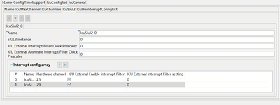

According to the reference manual, there're 4 interrupt vectors, and each contains 8 interrupt sources.
I want to configure Req[25] and Req[29], and they both map to SIUL_3_IRQn, which means they use the same handler. How do I distinguish them?

You need to read SIU status flag in the interrupt service routine to distinguish which one of eight EIRQ sources caused an interrupt.

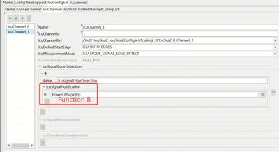

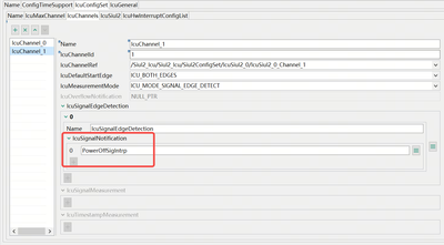

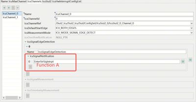

What about this? I just added two channels. Each channel has an IcuSignalNotification. I write two different functions and set to IcuSignalNotification respectively, so that I could distinguish them based on different notifications.

Okay. I'll try to make it clear.
My requirement is, when Req[25] causes an interrupt, I need function A to be called. And when Req[29] causes an interrupt, and I need function B to be called.
So, is it right if I configured as blew?
Thanks.
