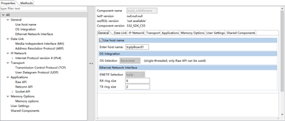

Hi all,
My project meet a PE problem.
It reports errors as:
ERROR: Unexpected status of script: Beans\tcpip\tcpip_update.chg, please contact Freescale support.
Generator: ERROR: There are errors in the project, please review components configuration. It is not possible to generate code.
The SDK version I use is S32_SDK_MPC574xx_RTM_1.0.0.
I can see something strange in tcpip_middleware in the Components view, which is the lwIP version is null.null.null and wolfSSL version is 'not available'.
Normally in a correct project the lwIP version is 2.0.2 and wolfSSL version is "3.12.0".
What's the reason for this error? How to fix it?

not sure what the problem is, but version RTM 1.0.0 is quite old, there's already RTM 3.0.3. So, I would try to update it as a first step.
Lukas
