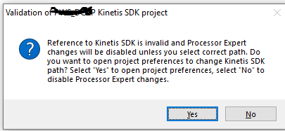

Getting below error when I open project which is created by one of the my senior. Checked for IDE updates but no pending updates and not able to resolve the error.
When I open project in S32 Design Studio for Arm 2018.R1 getting below error
and when project is opened in S32 Design Studio for Arm 2.2 getting below error
How to resolve this error.

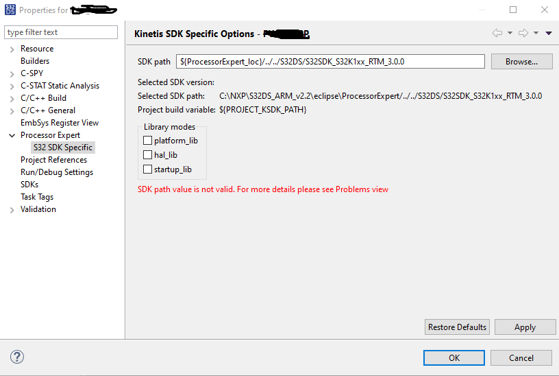

Hello, I suspect The project you are trying to open was created in some pre-release (EAR 1.8.7) version of SDK.
1) I'd suggest you to create a new SDK project for S32K116 (latest RTM version is 3.0.3)
https://community.nxp.com/t5/S32-Design-Studio-Knowledge-Base/S32-Design-Studio-for-ARM-2-2-Update-1...
2) add all the SDK components + setup from the original project
3) finally transfer all the non-generated source files. I suspect this will also require some adjustments on API level since there might be some changes between EAR vs. RTM releases of SDK.
If you intend on using the original project with the same SDK (1.8.7) you probably need to install S32DS for ARM 2018.R1 + Update 1 (https://community.nxp.com/t5/S32-Design-Studio-Knowledge-Base/S32-Design-Studio-for-ARM-2018-R1-Upda...)
Hope it helps,
Stan

When open project in S32 Design studio first I am getting
after selecting "Yes To All" getting
after selecting yes getting
after selecting and compiling the program getting error
5,993 Views
