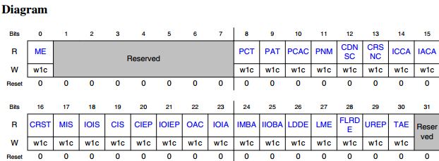

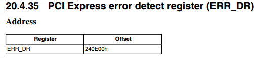

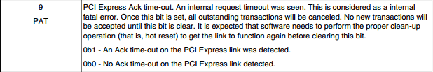

PCIE error(s) detected
PCIE ERR_DR register: 0x00400000
PCIE ERR_CAP_STAT register: 0x80000001
PCIE ERR_CAP_R0 register: 0x00000800
PCIE ERR_CAP_R1 register: 0x00000000
PCIE ERR_CAP_R2 register: 0x00000000
PCIE ERR_CAP_R3 register: 0x00000000

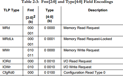

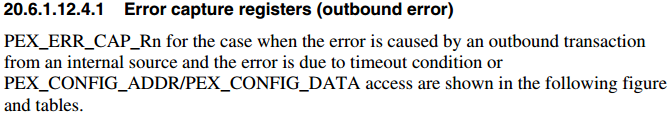

The below definition of ERR_DR register seems to indicate that  PCI Express Ack time-out.
PCIE ERR_CAP_R0 register: 0x00000800 --> FMT = 00 TYPE 00100
PCIE ERR_CAP_R* seem to indicate PCIE error happens when accessing Configuration Read Type 0
According to PCI Express Base Specification Rev3.0,
2.2.1. Common Packet Header Fields shows  "Fmt[2:0] and Type[4:0] field Encodings"
