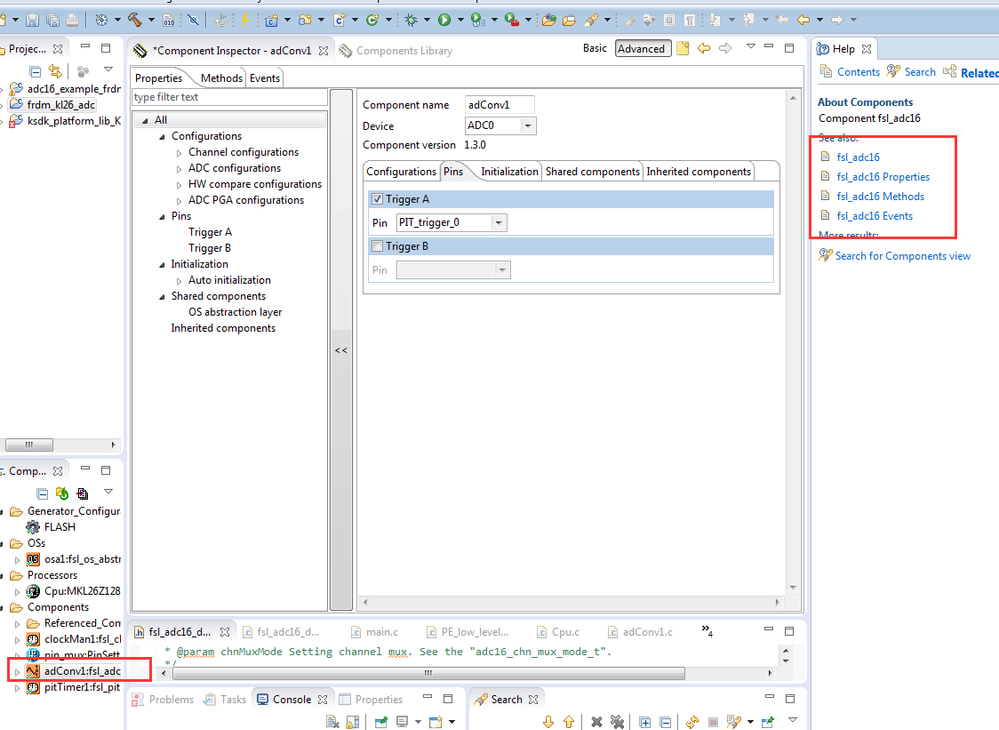

Diving deeper into the fsl_adc16 component, I notice that I can't initialize multiple channels unless I turn on hardware triggering (Maybe add why that is a requirement to the docs?). So I tried that. I enabled hardware triggering in adConv1_InitConfig0, pointed Trigger A to PIT_Trigger_0 (I also tried combinations of Trigger B and PIT_Trigger_1), and set up an fsl_pit component. There's no pin configuration  in the fsl_pit component so I'm just assuming it'll be on one of the PIT_Trigger pins...

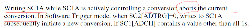

- From the Reference manual of your chip  :
so if you initialize two pins at the same time, the I think only the second one work.
- About the second channel  initialization, please change
ADC16_DRV_ConfigConvChn(adConv1_IDX, 1, &adConv1_ChnConfig1);‍‍
to
ADC16_DRV_ConfigConvChn(adConv1_IDX, 0, &adConv1_ChnConfig1);‍‍
then  read result also use
ADC16_DRV_GetConvValueRAW(0,0) ‍‍
- In the hardware trigger, if you use the PIT as trigger source, it needn't any pins for PIT.
After you configure the PIT correctly, it will the PIT trigger will automatically trigger ADC .
- About the hardware trigger , there is demo under KSDKv1.3 :
KSDK_1.3.0\examples\frdmkl26z\demo_apps\adc_hw_trigger
-About the PE, there is detail describe about the each component : right lick fsl_adc16 component -> choose "Help on component "
