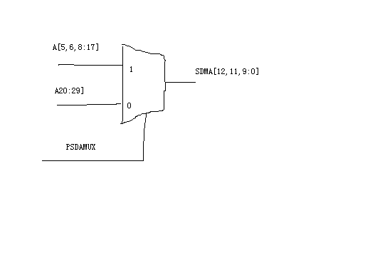

Hi,everyone, I use MPC8260A in my design, now I encounter some problems when debugging. When I access SDRAM in CodeWarrior unsing USB-TAP, an error message "writemem on target failed at address 0x400, size 0x1000". But when I only access 0x100 bytes, it's ok.  I measure signal waveform using DPO,  the timing is correct.
Sometimes I refresh data in codewarrior, the memory data will change. It seems the refresh timing is wrong.
MPC8260 is in 60x-compatible mode,66Mhz bus clock . 60x SDRAM is configured 32bit-port ,128MB(13 rows, 10cols,4 bank, 512Mb density), page-based mode.   So 60x SDRAM address is latched and muxed externally. Please help me to check the address connection?
BR: MS = 60x SDRAM, Port size = 32bit
OR: BPD = 01(4 bank), row start = A5, row number = 13
PSDMR:PBI = 1, SDAM = 100, BSAM = 010(A14-A16)
SDRAM BA[1:0] using dedicated pin BNKSEL[1:2].
  row         bank-sel         col
A[5:17],  A[18:19],   A[20:29]
SDRAM pins: BA1    BA0              A12    A11     A10     A9----A0
Phsical  :      A15    A16               A17    A18     A19     A20---A29
ACT    :      BNKSEL1 BNKSEL2    A5      A6     SDA10  A9--- A17
R/W     :     BNKSEL1 BNKSEL2     --       --       AP       A20--A29
60x address is muxed (using IDTQS3257):

You mentioned just a few fields of the PSDMR, can you let me know full PSDMR value?

PSDMR:PBI = 1, SDAM = 100, BSAM = 010(A14-A16), SDA10 = 011(A7), RFRC = 6 cycle, PRETOACT = 3, ACTTORW = 2 , BL = 1(8 bytes),  LDOTOPRE = -2, WRC =  2, EAMUX  = 1, BUFCMD  = 1, CAL  =  10(2),  .
The command bit changes with command being issued,  After issuing LOAD MODE REGISTER command,  RFEN bit is set.

I found the problem, the PSDMR[CL] field is not the same as value written by LOAD MODE REGISTER command, because in 60x-compatible mode , the LOAD MODE REGISTER value must be calaulted by user software.  The software can run in SDRAM.

The following is my initilization code using C code.  I port the code from one Demo , and work properly.  The only difference : Demo(64 bit port) in single-CPU mode ,but my board in 60x-compatible mode.
*ramaddr = 0x00000000;
M8260_PSRT(immrVal) = 0xB;
M8260_BR1(immrVal) = 0x00001841;
M8260_OR1(immrVal) = 0xF8002Bb00;
M8260_PSDMR(immrVal) = 0xAC4E277F; // Prechage
*ramaddr = 0xFF;
M8260_PSDMR(immrVal) = 0x8C4E277F;// CBR
for(i = 0, i<8;i++)
     *ramaddr = 0xFF;
M8260_PSDMR(immrVal) = 0x9C4E277F;
*(ramaddr + 0xCC) = 0xFF;
M8260_PSDMR(immrVal) = 0xC44E277f;
*ramaddr = 0xFF;
Thanks.

Can you check if line
is exact copy from the code?
And one more question about address connection to the SDRAM. Do you have address latch prior to address multiplexer?
4,186 Views
mengjunling
Yes, copy the code from Demo, but because the SDRAM port is not same, so OR1 is not totally same as Demo,
I have address latch(16373) prior to address multiplexer.
4,186 Views
Bulat
If (M8260_OR1(immrVal) = 0xF8002Bb00) is really used in the code, it can cause a problem. Value 0xF8002Bb00 (that is 0xF_8002_Bb00) seems to be mistaken, it contains 36 bits instead of 32 ones, so 4 upper bits are lost. Try to check its bit pattern against description in the Manaul.
