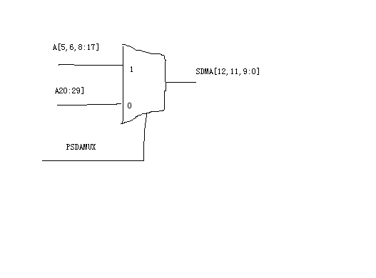

Hi,everyone, I use MPC8260A in my design, now I encounter some problems when debugging. When I access SDRAM in CodeWarrior unsing USB-TAP, an error message "writemem on target failed at address 0x400, size 0x1000". But when I only access 0x100 bytes, it's ok.  I measure signal waveform using DPO,  the timing is correct.
Sometimes I refresh data in codewarrior, the memory data will change. It seems the refresh timing is wrong.
MPC8260 is in 60x-compatible mode,66Mhz bus clock . 60x SDRAM is configured 32bit-port ,128MB(13 rows, 10cols,4 bank, 512Mb density), page-based mode.   So 60x SDRAM address is latched and muxed externally. Please help me to check the address connection?
BR: MS = 60x SDRAM, Port size = 32bit
OR: BPD = 01(4 bank), row start = A5, row number = 13
PSDMR:PBI = 1, SDAM = 100, BSAM = 010(A14-A16)
SDRAM BA[1:0] using dedicated pin BNKSEL[1:2].
  row         bank-sel         col
A[5:17],  A[18:19],   A[20:29]
SDRAM pins: BA1    BA0              A12    A11     A10     A9----A0
Phsical  :      A15    A16               A17    A18     A19     A20---A29
ACT    :      BNKSEL1 BNKSEL2    A5      A6     SDA10  A9--- A17
R/W     :     BNKSEL1 BNKSEL2     --       --       AP       A20--A29
60x address is muxed (using IDTQS3257):

You mentioned just a few fields of the PSDMR, can you let me know full PSDMR value?

PSDMR:PBI = 1, SDAM = 100, BSAM = 010(A14-A16), SDA10 = 011(A7), RFRC = 6 cycle, PRETOACT = 3, ACTTORW = 2 , BL = 1(8 bytes),  LDOTOPRE = -2, WRC =  2, EAMUX  = 1, BUFCMD  = 1, CAL  =  10(2),  .
The command bit changes with command being issued,  After issuing LOAD MODE REGISTER command,  RFEN bit is set.

Try to set PSDMR[LDOTOPRE] = -1, instead of -2.
And let me know whether this helps.
4,456件の閲覧回数
mengjunling
I have set PSDMR[LDOTOPRE] = -1,
I found the problem, the PSDMR[CL] field is not the same as value written by LOAD MODE REGISTER command, because in 60x-compatible mode , the LOAD MODE REGISTER value must be calaulted by user software.  The software can run in SDRAM.
But I have a new problem when using USB_TAP.  Now when I access SDRAM 0x200@0x0 size using Codewarrior Debug-> EPPC -> fill memory, then View memory, only the first 0x100 bytes space is filled and the beginning address(0x0-0x5) is not written, and the second 0x100 byte is not filled.
But when I fill memory every 0x100 bytes, all data is written and ok.
If the SDRAM is still is not configured properly. the software can't run from SDRAM.  I dont know why.

Bulat
If (M8260_OR1(immrVal) = 0xF8002Bb00) is really used in the code, it can cause a problem. Value 0xF8002Bb00 (that is 0xF_8002_Bb00) seems to be mistaken, it contains 36 bits instead of 32 ones, so 4 upper bits are lost. Try to check its bit pattern against description in the Manaul.
