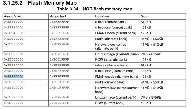

Hello all,
I am starting to use P3041 in a custom hardware (very similar with the P3041DS) and would like working with u-boot, but
I'm having a problem with NOR FLASH memory addressing. I'm using the Freescale SDK as reference and in this I have
following NOR_FLASH memory mapping.

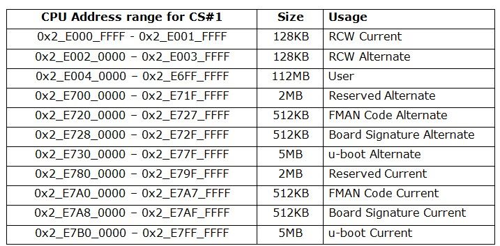

I my custom hardware I have the following NOR_FLASH memory mapping:
The problem occur when I change the #define CONFIG_SYS_TEXT_BASE 0xefffffff to #define CONFIG_SYS_TEXT_BASE 0xe7b00000, thus
the image to u-boot after compilation has 133MB of size.
What are the addresses should I change to work with u-boot on this custom hardware?

U-Boot goes at the end of flash.  You can't put it at arbitrary places such as 5MiB before the end.
The previous CONFIG_SYS_TEXT_BASE should have been something like 0xeff40000 or 0xeff8000, depending on U-Boot version (please specify such details when asking questions) -- not 0xefffffff.
Have you updated other symbols such as CONFIG_FLASH_BASE and CONFIG_FLASH_BASE_PHYS?
When you say that u-boot is "133MB", are you referring to u-boot.bin, or to the ELF "u-boot" file which has debug info, etc?
- The u-boot is at end of flash (0x2_E7B0_0000 - 0x2_E7FF_FFFF).
Sorry for my mistake about CONFIG_SYS_TEXT_BASE default value is 0xEFF80000. I am using u-boot source code in Freescale SDK V1.4.

If you use SDK 1.4 u-boot, it's better to allocate u-boot from 0x2_E7F80000 to 0x2_E7FFFFFF and define base address as the following.
#define CONFIG_SYS_TEXT_BASE    0xE7F80000
You also need to define reset vector address
#define CONFIG_RESET_VECTOR_ADDRESS    0xe7fffffc
According to your memory map, it seems that your are using 36 bit memory map, you need to use the definition in CONFIG_PHYS_64BIT.
