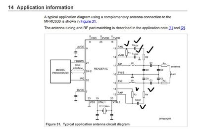

Hello everyone
I am working on MRFC6300 NFC chip as a reader. I have found the suitable components values for antenna design using the online tool available.
But I am unable to find values for the components marked in the attached picture. Can anyone guide me about this.
Thank You
1,073 Views
KaiLi
Hello @Nomi_malik
Thanks for contacting us and using the NXP products.
Yes, MFRC630 is not recommended for new designs. For new designs, please use the recommended product MFRC630 plus from the CLRC663 plus family. Please check the new online NFC Antenna Tool for the Antenna design by choosing CLRC663 plus, and there is a document also could be helpful to you, please refer to AN11019 (nxp.com.cn).
