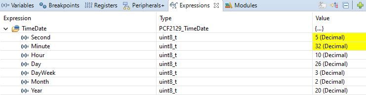

* In this example the time to be set is Wednesday, February 26 2020, 10:30 AM.

Setting the time and date by writing to registers Seconds (0x03) - Years (0x09):
Actual time and date shown in the Debug window:
