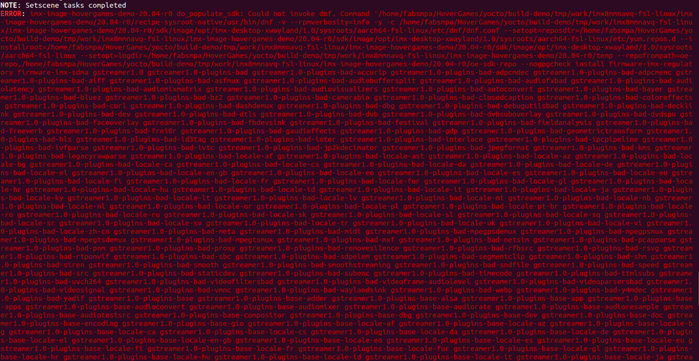

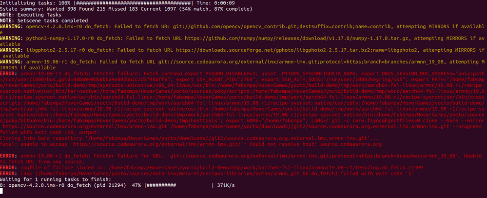

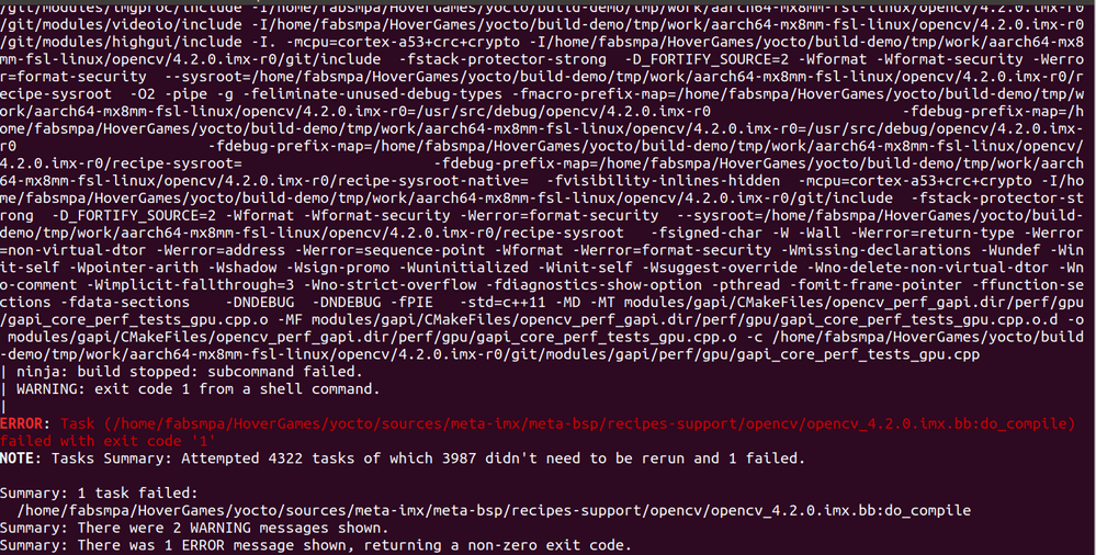

After source setup environment, i run:
 bitbake imx-image-hovergames-demo -c populate_sdk
I got following errors:
And the i get:

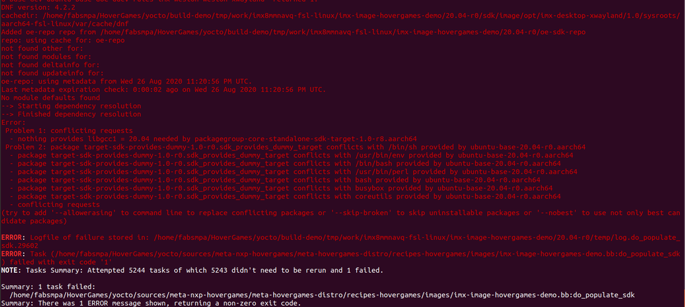

UPDATE
Packages seems to be compiling, but at the end of the image building task, i have:
At the top it says," imx-image-hovergames-demo-20.04-r0 do_populate_sdk: Could not invoke dnf "
I suppose this has to do with the fact that the package manager is RPM?
What could be happenig?
Thanks in advance

Okay. I asked some colleagues and this was the response:
So he can do either 2 things.
don't use the demo image and use the normal Yocto image then he can use the Yocto populate sdk.
Or setup an Ubuntu 20.04 system (or docker) which has the crosstoolchain for aarch64
`populate_sdk` doesn't work with the demo image because it is an ubuntu 20.04 root filesystem. But this means that you can cross-develop on an x86-64 machine with ubuntu 20.04 installed if you have the aarch64 toolchain, which you can install from apt (the package is gcc-aarch64-linux-gnu).
