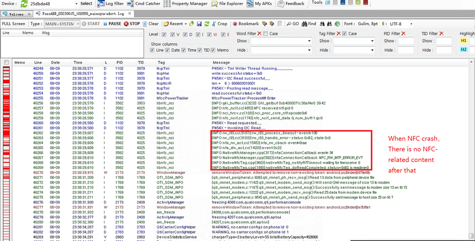

Qualcomm & Android13 & PN7160 & Type V tag
NFC crash after continuous swiping, " NFC_RW_INTF_ERROR_EVT " received in the log, and there is no NFC-related content after that.
Resume after restart NFC switch.
If anyone has encountered a similar problem, please share it, thank you!

HI @ethan_dang1
Could you please share a complete log?
After crash, is RF continuous on?

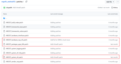

ethan_dang1
Hi @danielchen
The same situation occurred in another project, but it was OK until the latest patch is as follows.
Can you help?Thanks!

ethan_dang1
Hi @danielchen
Yes, after crash, RF is continuous on.
