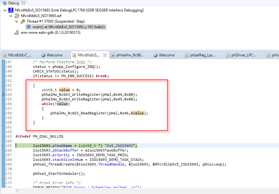

I tried with CLEV6630B, probing SIGIN pin with the following code, the result is always good. and SIGIN pin kept high even I let the example run freely. I am not sure if you could try it on a CLEV6630B as well.
Kan
4,699 Views

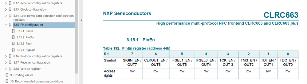

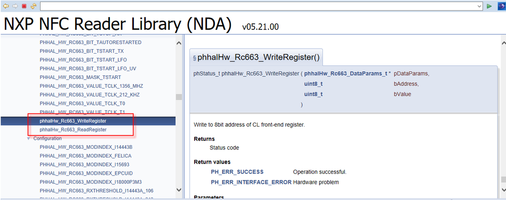

I am sorry, but no example available. The pin configuration is simple, only 4 registers are related with this function. Please refer to the following for details.
and you may use the API from the NFC reader library to set up these registers directly.
Hope that makes sense,
