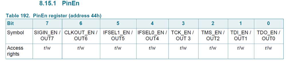

     OUT0~OUT7 all can be used as GPIO function. But these pins are multiplexed. You should do 2 steps for GPIO:
1. Enable them on corresponding bit in Register "PinEn"
[note]
     You can try to write 1 at bit0, and check if GPO function is enabled, otherwise write 0, please! I also didn't find detailed description on 1 or 0 for GPO function.

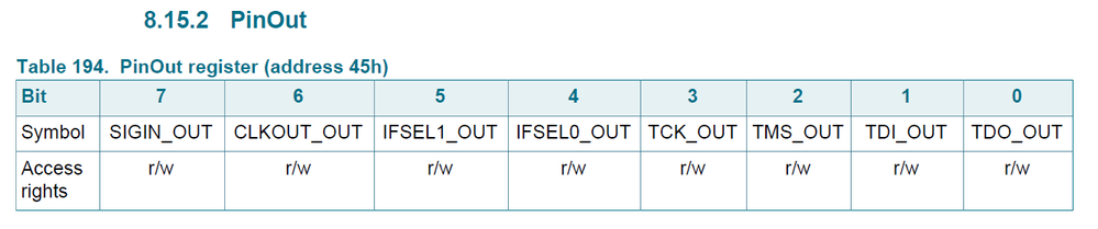

2. Output High Or Low  in Register "8.15.2 PinOut"
Write 1 on related bit, High level should be output, otherwise Low level.
