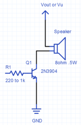

I am trying to generate an audio output with sine wave generation on Simulink. With arranging the frequencies and duty cycle, i can currently output a sinusodial PWM from pins. I feed it into a basic low-cost class-AB amplifier. I was wondering if i can directly use s32k144 as a Class-D amplifier. This type of amplifier basically transforms analog signal into a high frequency PWM and then filters it to original signal with higher amplitude. S32k144 can output 0-5V PWM, so theoretically i can low-pass filter it and connect it to a speaker. My concern is the current consumption. Will the speaker try to consume more current? I think the maximum current is about 30mA in s32k144, please correct me if am wrong.
In summary, i am trying to generate audio with the PWM output of the microcontroller. Do i need to amplify it? I already have 0-5V output from PWM.
Thank you.

Hello Umut Ülker,
Regarding the request above, may I ask what application do you want to design?
In general, all microcontrollers' pins have a very limited current output (10-25mA), and they cannot be used as a Class-D amplifier.
Instead, the typical diagram should be the following:
The PWM pin from MCU is filtered and current is limited by a resistor that is feed to a driver, and its outputs is tied to the Load (speaker).
The Driver can be an Op-Amp for low power application or headphones, or it can be a Class-D amplifier for speakers.
A very simple schematic to test the Sine output from S32K144 is the following:
Where Vout is 5V, Q1 is a simple NPN transistor 2N3904 and the PWM output pin of the S32K144 is connected to R1 resistor with values from 220 to 1k Ohms.

I was trying to generate audio signals from the s32k144.
Just as I thought, I need a MOSFET driver then for higher power outputs. My speaker can output maximum power of 9W. So the circuitry should be like this: PWM pins -> Filter -> MOSFET Drivers -> MOSFET bridge -> Speaker. Am I correct?

Hi Umut,
Yes, for a speaker of that high power 9W, you will need a MOSFET bridge with driver, and details are in previous post regarding connections.
