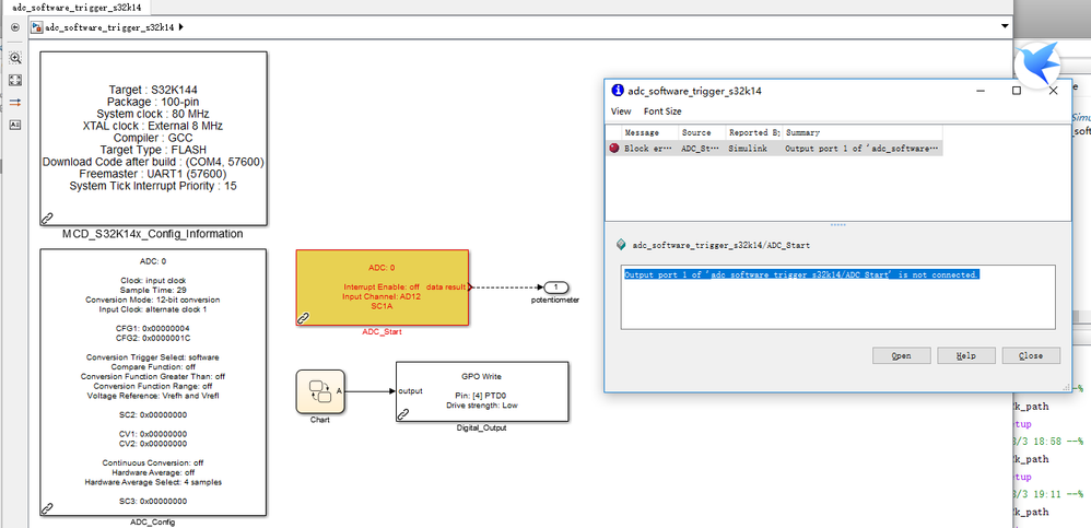

Hi Radu,
     I use MCToolBox example project "adc_pdb_trigger_s32k14.mdl" , occur this error . Could you help me kill this error ?
 Thanks !
     Feng
3,864 Views
raduivan
Hi Feng,
   Please delete and remake the link between ADC block and output port. From the screenshot you attached, the error occurs because those two blocks are not connected.
Radu

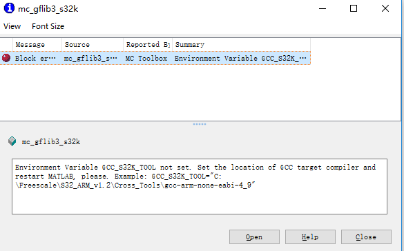

     I installed the "Motor Control Toolbox" again , i building the project in the simulink ,occur this error  :
i can't understand the "setting  up the target compilers" like this ; How can i  do it follow this .
 Many many thanks !
Feng
3,864 Views
raduivan
Hi Feng,
   First you need to install the compiler you intend to use and after you need to set an Environment variable which will point to the installation folder. Let me know if you need more information.
