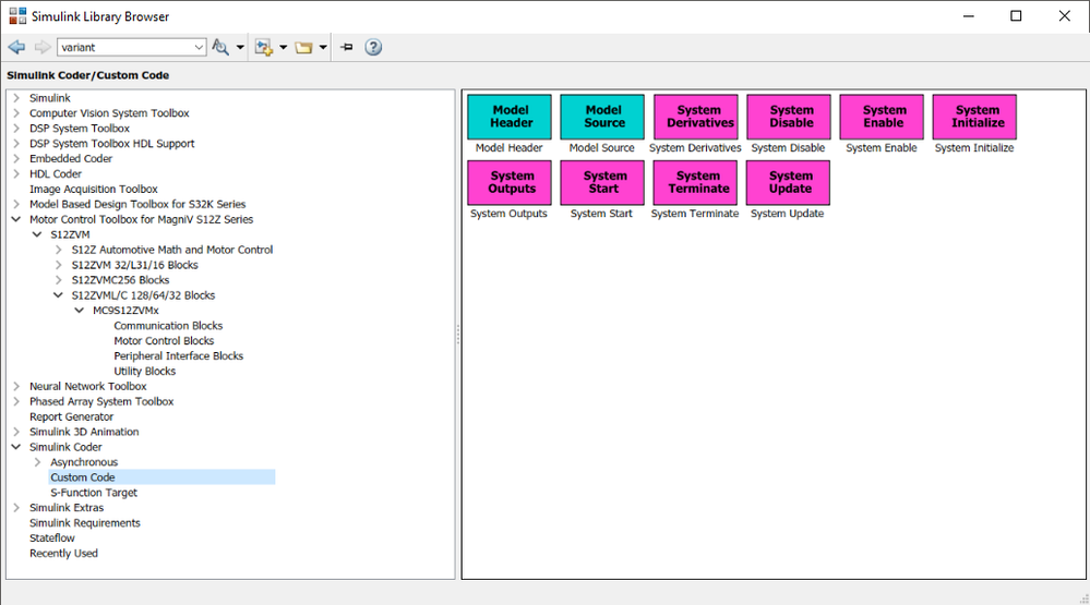

#3: you could use the Simulink Custom Code and implement your own PMF/GDU start/stop sequence and call that piece of code in your Simulink model.
