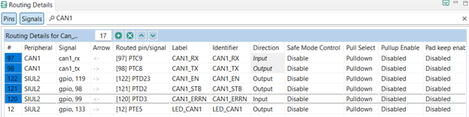

I am testing freemaster over Peak CAN and I am facing some issues. I have done the configuration for CAN1 & CAN2. On default Software settings from nxp MBDT for CAN0 & CAN4, I am able to use freemaster over peak CAN over CAN0 but not for CAN1, CAN2 or CAN4. I have done the following:-
1. Added the flexcan0, flexcan2 & Flexcan1 in default CAN0 config which enables the freemaster use over peak CAN, but configuring CAN0, CAN1 or CAN2 manually does not work for freemaster.
2. Hardware objects are configured for both transmission and reception.
3. Also the Pins and ports have been added for the respective pins.
4. Also Configuring this, transmission and reception is not working for any CAN channel.

For each CAN instance the following pins need to be configured:
Please note that each CAN instance uses its own transceiver which can differ from the ones used by the other instances and transceiver initialization may consist of setting the CAN_EN and CAN_STB pins to High state or more.

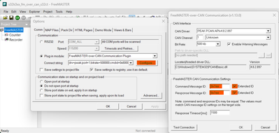

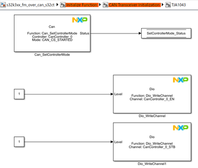

I had a look on the Simulink model you provided and I couldn't find any initialization for the CAN transceiver. Normally this is done in the "initialize" block and it usually implies setting a few DIO pins to certain values depending on the hardware connections on the electrical board. For reference, please check the FreeMASTER over CAN example in your toolbox:
It can be found at this location: "S32K3_Examples\fm\s32k3xx_fm_over_can_s32ct".
While at this path, right click on file "s32k3xx_fm_over_can_s32ct.pmpx" and then click on "Open Outside Matlab". This launches the FreeMASTER PC application with some settings already configured. Please make sure that both "Command Message ID" as well as "Response Message ID" are set to value 0x7aa and both have the "Extended ID" checkbox checked. You can get to this menu by navigating to "Project -> Options... -> Comm tab -> Configure... button":

Activating the CAN transceiver is an operation that is hardware specific, that's why it is important to check these details:

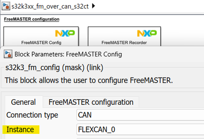

1. What CAN instance is used by the FreeMASTER Config block? The example comes by default with FLEXCAN_0

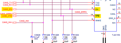

2. Based on the schematic document of your board, what CAN transceiver is connected to that specific instance?
3. To which pins of the microcontroller are the transceiver's CANx_EN and CANx_STB (same x as for FLEXCAN_x) connected to?
4. Are these two pins of the microcontroller created and configured in the S32CT configuration and their state (High/Low) corresponds to transceivers requirements (EN requires High, STB requires also High to avoid standby)?
You can refer to this article for more details on how to configure the digital output pins for the CAN transceiver: Communicating over the CAN Bus (see chapter 2. CAN Configuration)
