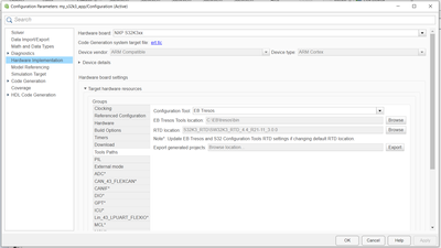

Error "The system cannot find the path specified." shown after clicking "Configure..." button in "Dio" block.
I am following this training video step by step:
https://www.nxp.com/design/training/deploying-autosar-and-non-autosar-software-components-on-nxp-s32...
At 9:42, it mentions clicking "Configure..." button in "Dio" block will open the EB Tresos.
However, I got this error info.
My hardware setting:
I have installed EB tresos v29:

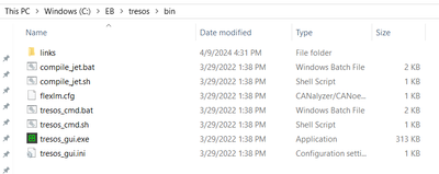

Hi, @xianzhi_g ,
Thank you for your interest in the Model-Based Design Toolbox for S32K3.
The problem you are facing is that the EB tresos folder cannot be found. Make sure you select the C:\EB\tresos path instead of C:\EB\tresos\bin, as in the following picture.
I hope this helps,
Dragos
