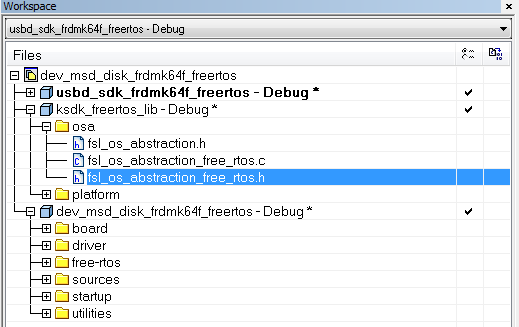

I'm still using the v5.0 beta of the Freescale BM USB stack and I'm curious if there's an RTOS adapter for it already written for FreeRTOS.  I realize it's deprecated but switching to KSDK and MCUXpresso is simply not an option right now - I've got deadlines to meet and that's going to be hard enough without switching tools in the middle of everything.  It's working well enough now but I see that it supports running as a task in MQX, and if I can do the same in FreeRTOS to reduce the amount of processing done in interrupt context, that would be useful.

Hi SCOTT MILLER
KSDK USB is based on usb 5.0, I would suggest you refer to the adapter files for FreeRTOS, these files are from KSDK1.2
