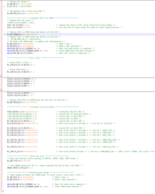

when I from boot jump into app ,I find the peripherals like can ,adc can not work,but led blink succeeful。I guess it's because of the clock configuration,help me find the reason.below  is my codes.

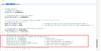

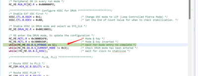

recently ,I even tried to use same block init code  in boot and app project(The screenshot at the bottom is my code).I still dont know why the progress of programe  is stuck here
It  mean  mode can not  transition from drun to drun .Than I test set boot use RUN0 ,app use DRUN, that do not work also.
Does this mean that the two projects cannot use the same clock setting?

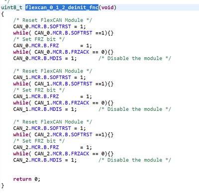

The mode transition is usually stuck due to fault in FCCU [NCFSx] register or clock is still supplied to some module (CAN for example) and need to be terminated before mode transition.
If the peripheral is still actively clocked, mode transition will fail.
Last but lest possible is that PLL is not stable. (weak power source, wrong clock configuration).

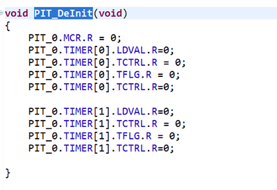

before jump to app programe,I have closed the peripherals which has been opened ,and recovery them to the default values,clean ram and disable the interrupt.

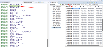

shaoduoduo_3-1670468821363.pngshaoduoduo_3-1670468821363.pngshaoduoduo_4-1670468838055.pngshaoduoduo_4-1670468838055.png
I debug the project .
It seems that status bits in FCCU NCF,location at 0XFBF58080,is 0.

Ok. For reading faults of FCCU NCFSx registers you ahve to apply the procedure. Hope you are aware of that, otherwise you will always read 0 even if there are faults latched.

I located my mistakes.
when I use the same funtion of MC_MODE_INIT in boot and app programe,the mcu can not work.
If I mask this section in app programe, the program can jump smoothly.
At this time, the MCU is using  PLL1 (200 MHz) as the system clock(setted in boot programe).if MCU Enable XOSC in DRUN mode and select as SYS_CLK in app programe ,core trigger error.
The solution is not to let MCU enter the DRUN mode with using XOSC as  SYS_CLK , directly configure PLL clock, and then enter the DRUN mode after the pll clock have been configured .
Am I right?
