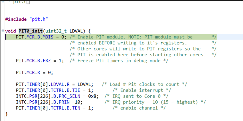

     I am debugging the Muti_core, but i only have one Demo as below . But it seems that the Project can't work.
When i open the other two cores in the hw_init() function, then the project shows error.
can you give me some advice , or deliver a  muti_core that can work ok?
Thanks.

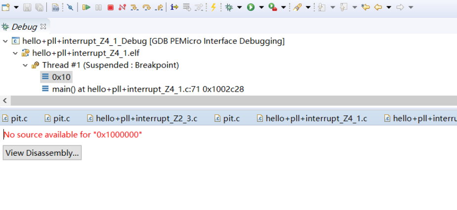

    To the multi core project, the question "error " means, when into the Pit function ,the IDE report the error below:
I compare it with the other PIT project which can work normal , they are all the same. I feel strange very much.
 Can you give me some advice?
Thanks.

petervlna
No source available usually is only debugger fault when he is not able to reach the correct path to the source file.
Check if the SW runs without debugger.
If yes, then fix the paths of files for debugger.
regards,
Peter
