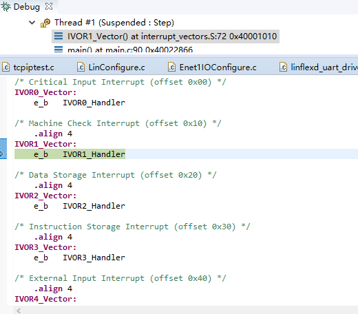

I need to do LIN development on MPC5748G, but after setting the INIT bit of LINFlexDx_LINCR1 register to 1 (set into initialization mode), I continue to set the UART bit of LINFlexDx_UARTCR register to 0 to enter LIN mode. It goes straight into the Machine Check Interrupt. What's going on here?LIN寄存器设置.png

be sure module is clocked and wait for INIT mode to be entered.

Hello, thank you for your answer, but I set my registers according to the initialization operation (LINFlexD_1_Init) in the example program in the link you sent, but after this sentence (LINFlexD_1.LINCR2.R = 0x4000), I still entered the error interrupt. What's going on here?

I do not see reason for this, check if right address is accessed.
There is no SDK driver for LIN, MCAL driver would include LIN driver however;
