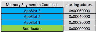

The goal of the bootloader application is to be able to store up to 3 different applications in the
codeflash (512KB CodeFlash), that can be executed by the bootloader.
The layout of the codeflash should look like this in the end:
I limit the application size at 110KB for the moment (an AppSlots is about 125KB).

1) Alter and build the test-app for a specific AppSlot (let's say AppSlot 1).
2) Launch the flashed test-app using the bootloader.
What I did so far:
regarding 1)
- Setting the linker to build the test-app for AppSlot 1:
I looked at the linker control file (.lcf), which is provided by creating a project with the project wizard of codewarrior.
In particular the one for running an application in FLASH. In the memory section, I offset every entry by 0x00020000.
The resulting file is shown in attachment 1.
Furthermore I offset the "ROM Image Address" and "RAM Buffer Address of ROM Image" by 0x00020000 as well.
The result can be seen in attachment 2.

Hello Marcus,
Regarding your bootloader questions:
1) Setting the linker to build the test-app for AppSlot 1: you correctly set up the .lcf file + ROM image address in order to link your test application into App Slot 1 memory segment.
You can check the generated srecord .mot or .map file that the addresses fit the segment well.
- offsetting the interrupt vector table:
I assume you use the default FLASH project generated by the BareBoard project wizard as a template. The default project includes startup with interrupt controller initialization which also sets up the IVOR (Interrupt Vector Offset Register) to match with the start adress of exception_handlers memory section. So once the execution of TestApp reaches main() the value of IVOR should be 0x0002_1000 (this is address where your exception branch table for TestApp is placed).
2) Launch the flashed test-app using the bootloader:
Since your TestApp application is probably based on FLASH build configuration generated by BareBoard Wizard the "resetvector" section contains RCHW (Reset Conguration Half Word) +  Reset Vector.
See below the snippet of .map file that illustrates the content of this section:
.__bam_bootarea section layout
  Starting        Virtual  File
  address  Size   address  offset
  00000000 000008 00020000 00000240  1 .__bam_bootarea MPC5604B_init_flash_c.obj
  00000000 000004 00020000 00000240  4 bam_rchw MPC5604B_init_flash_c.obj
  00000004 000004 00020004 00000244  4 bam_resetvector MPC5604B_init_flash_c.obj
The reset vector start address = TestApp entry point is located at offset +4. You should therefore jump at address located at App Slot 1 + 0x4.
See MPC5604B reference manual for more information about RCHW and reset vector.

markusren
Hello Stan,
thank you very much for your response!
to 1)
- Setting the linker: good to know that this is all that is needed for offsetting the build settings.
- offsetting the interrupt vector table: Yeah you are right, the project is based on the default FLASH project settings and I only changed the linker settings (lcf-file, ROM-addresses, output one binary). I hoped that the provided startup routine would take care of offsetting the interrupt vector table, so that is nice.
Just searched for the IVOR register in the reference manual again, but there is no such register.
I assume the function __asm void INTC_INTCInterruptHandler(void) (IntcInterrupts.c) handles this by manipulating the INTC_IACKR register.
to 2)
So the address of the bam_resetvector is the important part for the jump and it explains the offset by 4 bytes. I will check out the BAM chapter again.
So I set the offset to 4 and created a void function pointer for making the jump.
And it works!!!
I created build profiles for the 3 specifed AppSlots, build and flashed the test-apps. Each slot and the associated jump works fine. I also tested the test-app with interrupt blinking. Works too.
This is a pretty big milestone for this project! I can continue to implement the remaining features of the bootloader now.
So thanks again for the clarification!
Markus
