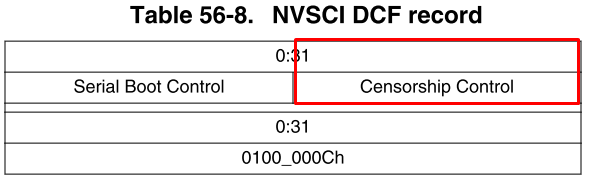

The device can be secured by adding a Non-Volatile System Censorship Information (NVSCI) record to the DCF record list in the UTEST Flash block.
A value of 55AAh in the censorship control word of the NVSCI record determines that the device is unsecured, any other value determines that the device is secured.

1. Program NVSCI DCF record to first available space in UTEST memory.
   data.set 0x00400308 %QUAD 0x55AA12340100000C ;NVSCI - Censorship Control enabled
2. Program Censorship password (0x1234567812345678)
   data.set 0x00400310 %QUAD 0x1234567801000004 ;NVPWDL
   data.set 0x00400318 %QUAD 0x1234567801000008 ;NVPWDH
