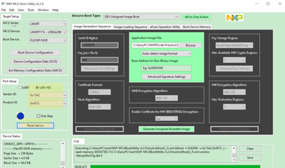

If you want to use the SPT or other tools, you neet to use these steps:
1. Board enter the serial download mode
SW1:1-OFF,2-OFF,3-OFF,4-ON
SW2:0000000000
2. Find another USB cable to connect the J20, then you can use the mcubootutility to connect it
https://github.com/JayHeng/NXP-MCUBootUtility/releases/tag/v6.2.0
the related user manual is:
This is the connection result:
You can find it is connected, please also try it on your side.
Then mass erase use this one:
Please try it on your side.
If yu still have issues, you may need to check, whether your board have issues or not, or you modify the fuse bit or not.
kerry

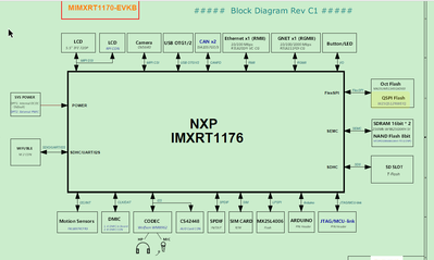

2. To the MIMXRT1170-EVKB, please download the EVKB related SDK, and import the code from the EVKB SDK:
https://mcuxpresso.nxp.com/en/builder?hw=MIMXRT1170-EVKB

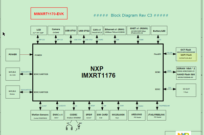

3. About the EVK and EVKB, the used QSPI flash is different, so the XIP FCB have difference.
This is the EVK flexspi_nor_config.c
#define FLASH_DUMMY_CYCLES 0x09
#define FLASH_DUMMY_VALUE  0x09
const flexspi_nor_config_t qspiflash_config = {
    .memConfig =
            .tag              = FLEXSPI_CFG_BLK_TAG,

This is the EVKB flexspi_nor_config.c
#define FLASH_DUMMY_CYCLES 0x08
#define FLASH_DUMMY_VALUE  0x03
    .memConfig =
            .version          = FLEXSPI_CFG_BLK_VERSION,
            .readSampleClksrc=kFlexSPIReadSampleClk_LoopbackFromDqsPad,
            .csHoldTime       = 3u,
            .csSetupTime      = 3u,
            // Enable DDR mode, Wordaddassable, Safe configuration, Differential clock
            .controllerMiscOption = 0x10,
            .deviceType           = kFlexSpiDeviceType_SerialNOR,
            .sflashPadType        = kSerialFlash_4Pads,
            .serialClkFreq        = kFlexSpiSerialClk_133MHz,
            .sflashA1Size         = 64u * 1024u * 1024u,

You can see, the LUT, the dummy cycle have difference.
So, if you want to use the EVK demo to download to the EVKB, you need to modify the flexspi_nor_config.c code to the EVKB code.
In fact, I suggest you use the EVKB SDK directly, that will be more easy to you.
Wish it helps you!
