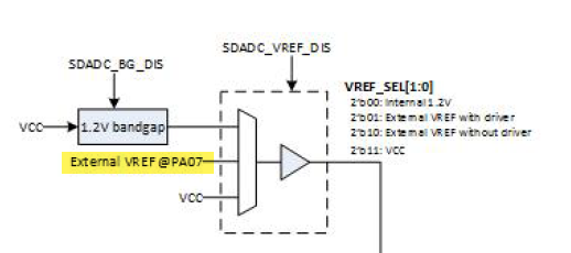

I am using qn908xcdk_wireless_examples_bluetooth_wireless_uart_freertos demo code for my development. In my application, I want to use External Vref @PA07. An external voltage is 3.3.
The demo application is configured as 1.2 V bandgap. I changed the following parameters
adcConfigStruct.refSource = kADC_RefSourceExtWithDriver; ---> In ADC_Init conifguration
adcSdConfigStruct.vinnSelect = kADC_VinnSelectVref; --> In ADC_SetSdConfig configuration
Do I need to do anything else? When I use 1.2 Internal application is giving proper ADC output through ADC_ConversionResult2Mv. But if I use PA07 then I am not getting proper output through ADC_ConversionResult2Mv API.

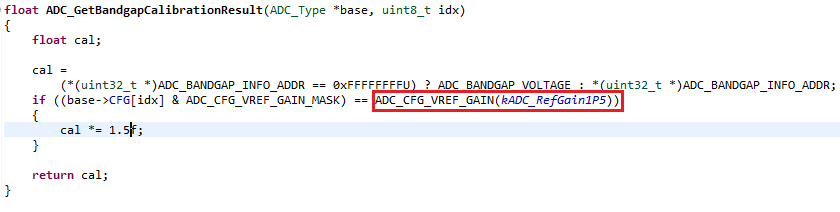

The steps you followed are correct. However, if you check ADC_ConversionResult2Mv API needs your reference value.
In ADC_basic example that value is assigned with the following function.
This function multiplies the reference value as follows (1.5*reference):
If you multiply your external reference value by 1.5 and put it in the ADC_ConversionResult2Mv API, you should get the correct mv value from the ADC.

FelipeGarcia
Hi Ashkan,
Please see my answers below:
1. PA07
2. You actually don't need to read it. Just make sure you configure it correctly in adc_config_t.

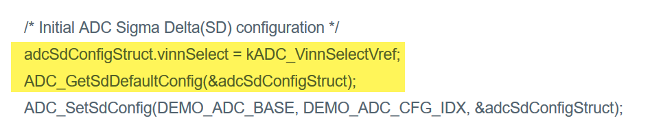

Ok, so what I did was correct. however, when I put "3.3*1.5" instead of "g_AdcBandgap", the result is not correct and it is always higher than real values. Why?
This is my ADC configuration:
ADC_GetDefaultConfig(&adcConfigStruct);
adcConfigStruct.channelEnable = (1U << DEMO_ADC_CHANNEL);
adcConfigStruct.channelConfig = (DEMO_ADC_CFG_IDX << DEMO_ADC_CHANNEL);
adcConfigStruct.triggerSource = DEMO_ADC_TRIGGER;
adcConfigStruct.convMode = kADC_ConvModeSingle;
ADC_Init(DEMO_ADC_BASE, &adcConfigStruct);
/* Initial ADC Sigma Delta(SD) configuration */
ADC_GetSdDefaultConfig(&adcSdConfigStruct);
ADC_SetSdConfig(DEMO_ADC_BASE, DEMO_ADC_CFG_IDX, &adcSdConfigStruct);
And this is my conversion:
fresult = ADC_ConversionResult2Mv(DEMO_ADC_BASE, DEMO_ADC_CHANNEL, DEMO_ADC_CFG_IDX, 3.3*1.5, g_AdcVinn,
                                                            adcConvResult);
3,316 Views
FelipeGarcia
Hi Ashkan,
I think you are overwriting adcSdConfigStruct with the default configuration.
Please try to execute adcSdConfigStruct.vinnSelect = kADC_VinnSelectVref; after the default configuration call.
Felipe
