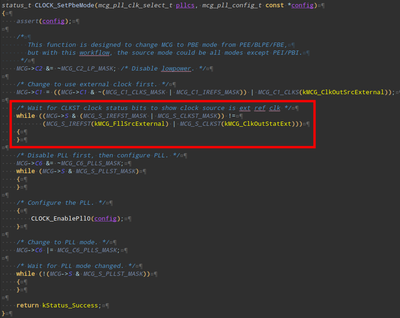

I'm struggling with my clock configuration. I configure it like in the following image:
But the execution is getting stuck in this while:
With the following call tree:
I found a similar post here but it is unanswered, and according to the answer offered by @kerryzhou, the HGO0 bit should be 1 but MCG_C2 is disabled in my configuration and I can't modify it.
I'm trying to configure an MK10DN512VLQ10 with an external 8MHz crystal.

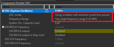

Your project still was getting stuck in the same place. After poking around I noticed that I had to semi-manually configure these two options:
I say semi-manually, because I didn't have to do that directly in the source code, but neither through the graphical configurator. To configure those two options I had to select the System oscillator block in the clocks diagram to get those options in the Details view on the right and manually select the correct options.
I had to select the OSC Mode as "Using oscillator with external crystal (low power)" and the Frequency Range as "Very_high frequency range 8-32 MHz".
There is another option for OSC Mode which is Using oscillator with external crystal (high gain) but that one doesn't work despite it is also for an external crystal.
For the Frequency Range, you can use Very_high frequency range 8-32 MHz or High frequency range 3-8 MHz, it is the same with those two, the values don't change in the generated code (which makes me wonder why those two options exist).
I attach the .mex config file in case anyone wants to take a look.

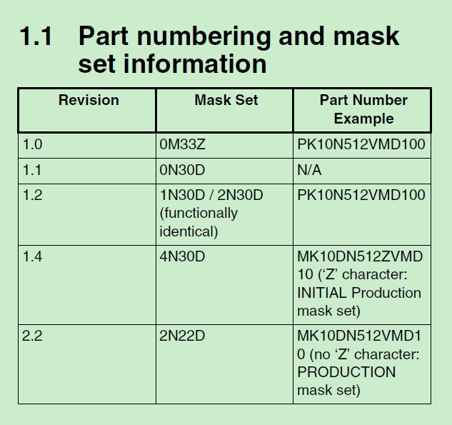

   Please also check your chip maskset number: You can find it in your chip
Make sure it is 2.x chip.
https://www.nxp.com/docs/en/application-note/AN4445.pdf

  1. My chip says 5N22D. I don't know what version is that (5.X?) but I think I'm good here, am I?
Answer: Your chip is the 2.x chip, it's oK, you can use SDK_2.2.0_MK10DN512xxx10 as your chip SDK.

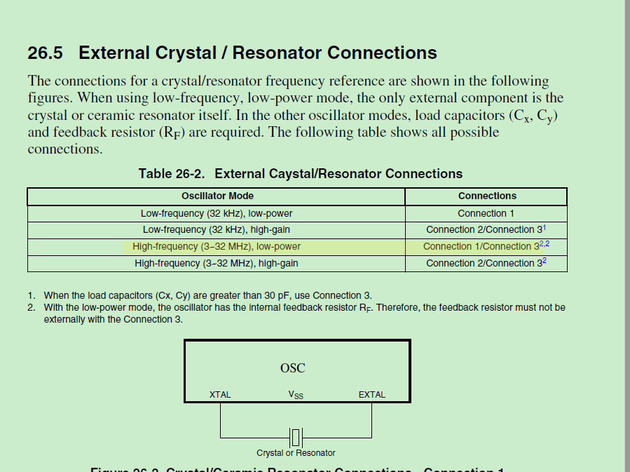

  In fact, the low power mode also can be supported, do you add the feedback resistor in the OSC circuit?
You can check the code,
const osc_config_t oscConfig_BOARD_BootClockRUN =
.freq = 8000000U, /* Oscillator frequency: 8000000Hz */
.capLoad = (OSC_CAP0P), /* Oscillator capacity load: 0pF */
.workMode = kOSC_ModeOscLowPower, /* Oscillator low power */
.oscerConfig =
.enableMode = OSC_ER_CLK_DISABLE, /* Disable external reference clock */
CLOCK_InitOsc0(&oscConfig_BOARD_BootClockRUN);
CLOCK_SetXtal0Freq(oscConfig_BOARD_BootClockRUN.freq);
void CLOCK_InitOsc0(osc_config_t const *config)
uint8_t range = CLOCK_GetOscRangeFromFreq(config->freq);
OSC_SetCapLoad(OSC0, config->capLoad);
OSC_SetExtRefClkConfig(OSC0, &config->oscerConfig);
MCG->C2 = ((MCG->C2 & ~OSC_MODE_MASK) | MCG_C2_RANGE(range) | (uint8_t)config->workMode);
if ((kOSC_ModeExt != config->workMode) && (OSC0->CR & OSC_CR_ERCLKEN_MASK))
/* Wait for stable. */
while (!(MCG->S & MCG_S_OSCINIT0_MASK))
So, the low power mode with 8Mhz should also works, but you need add the RF in the circuit, normally 1Mhz, do you add it?

@kerryzhou I have tested the project you include and it works. But I don't understand why are you executing the CLOCK_BootToFeiMode, I mean, I need to go to PEE mode, not FEI.
I was able to make my code work and not get stuck in CLOCK_BootToPeeMode by making the changes in the clock config tool I mentioned in my previous post. The "secret" is:
  • Configure OSC Mode as "Using oscillator with external crystal (low power)
  • Configure Frequency Range as "Very_high frequency range 8-32 MHz" or "High frequency range 3-8 MHz"
That way I don't need to execute CLOCK_BootToFeiMode as you suggestIf I do that, then I will also have to execute CLOCK_SetFbeMode, then CLOCK_SetPbeMode, and finally CLOCK_SetPeeMode to transition the clock from FEI to PEE according to the transition diagram in the RM which seems a lot and unnecessary since that can be done on a single call to CLOCK_BootToPeeMode.
