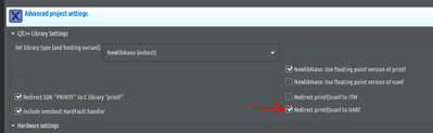

When creating a project, I can see the option for redirecting printf/scanf to UART:
But I can't see any option neither in the Peripherals Configurator nor in the Pins Configurator to "connect" the UART in my board with printf (UART3 in my case).
Is there any document or resource I can check out to know how to do this?

For anyone landing here, this was the solution in my particular case. It is just a matter of adding the following call to void BOARD_InitDebugConsole(void) since it is generated empty.
    /* The user initialization should be placed here */
    DbgConsole_Init((uint32_t)UART3, 115200, DEBUG_CONSOLE_DEVICE_TYPE_UART, CLOCK_GetFreq(kCLOCK_BusClk));
In my case is UART3 @ 115200 but you can substitute those for your particular needs.
