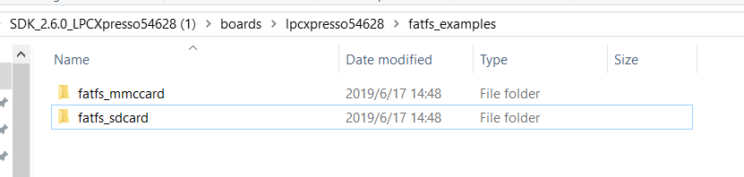

Hello  Donald Swearingen ,
 I just download the SDKv2.6 package for LPCxpresso54628, it still includes this demo "fatfs_sdcard", you can find in the path:

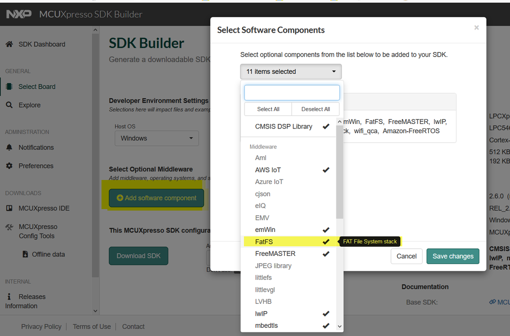

And pay attention, please select FatFS when download SDK package:

Hi Alice,
Thanks. Yes, this is what I needed. When I first downloaded the SDK, I
was following instructions for setting up and I just took the defaults.
I was not aware that I could add other items to the SDK.
