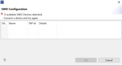

The FRDM-KW36 board was connected to a PC with a USB cable, and it was confirmed that the debugger can be connected from the MCU Xpresso IDE using the hrs example included in the SDK.
However, when I tried to connect to the debugger the next day, an error occurred and I could not connect.
Since the console log and USB connection are recognized as a USB device, we believe that there is a problem with the connection between OpenSDA and the target.
Can you tell me how to deal with it or what you need to check?

So far, I've tried the following, but none of the results have changed:
・Change USB cable
・Change USB port: Confirm both USB2.0 and 3.0
・PC change

Sebastian_Del_Rio
Hi Akihito,
The error is happening because the Heart Rate Sensor (hrs) SDK example makes use of the Low-Power mode for the device, causing it to go to a determined power mode, and to disable the required pins and systems to enable debugging.
To prevent this, and for a better experience while debugging your MCU, Low-Power mode can be disabled by changing the following macro definition to a "0":
/* Enable/Disable PowerDown functionality in PwrLib */
#define cPWR_UsePowerDownMode           0
This will disable Power Down functionality for the demo application. This is recommended during debugging, but it can be enabled again for later steps of development.
Please let me know if you need any more information.
Sebastian

fuzy
Hi, Sebastian
I've confirmed that the problem can be solved in the way you taught, but it always seems to recur when disconnect the debugger.
I unlock every time. Is there a workaround?
The debug target is the hrs example based software included in the SDK.

fuzy
Hi, Sebastian
The problem was solved in the way you taught. Thanks for your advice!
