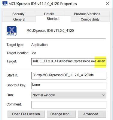

Do i actually need to write -nl en somewhere else?
9,051 Views
ZhangJennie
Normally we can add it here.
8,886 Views
Goderfer
It still the same
