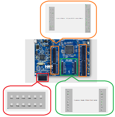

An expansion header is a collection of expansion connectors placed on the development board. The pins from the connectors lead out the processor pins outside and can be identified by a label on the board. There can be multiple expansion headers on a single board. 
Figure 1. Example of three expansion headers on- LPC55S69-EVK board

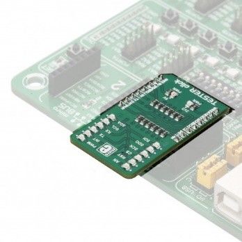

An expansion board is a circuit board that can be applied to the Expansion header, extending features of the development board. Expansion boards (sometimes called Shields) can contain special additional components such as wireless modules, sensors, and so on. The connected pins may have different names on the expansion board. 
If an expansion header is defined in the configuration, then the pins tool can provide instant routing of the processor signals appropriate for the expansion board applied to this header.
Figure 2. Expansion board example - Tester click[https://www.mikroe.com/tester-click]

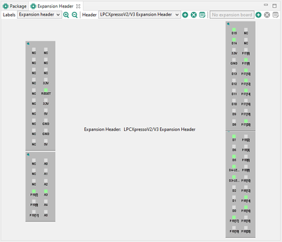

The Expansion Header view can be found in the Pins tool. The view shows the header connectors and pins in graphical form, with the layout corresponding to the layout of the real board.
Figure 3. Expansion Header view
The Expansion Header view can simplify work with the pins connected to an expansion header. By moving the cursor on a connector pin, you can see the details on the pin's connection and routing. You can also route processor pins signals by left-clicking on the connector pin or by right-clicking to invoke the context menu.

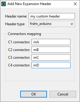

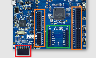

  4. The Expansion Header dialog appears
    • Set the header name, type, and connector names to match your hardware design.
           Figure 5.  Add New Expansion Header dialog
               NOTE: The number of connectors and arrangement is determined by the header type.
          Figure 6. Example of the header types (orange: Lpc-style arduino; red: Pmod; green: Micro Bus)

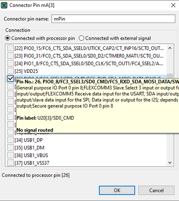

    2. The Connector Pin dialog is shown
        Figure 9. Connect dialog for the 3-d pin on connector “mA”, set name “mPin” and connected to processor pin on coordinates 26
    3. You can set the name (for example, the label of the pin on the header); otherwise, the connector pin coordinates will be used instead.
    4. If the pin is connected to the processor, check the checkbox connected with the processor pin. In this case, check the connected pin checkbox from the list.
    5. If the connector pin is used but is not connected to the processor, you can select external signal types, which will be used for validating features of the matching signals when the expansion board is applied to the header.
    6. You can also disconnect the pin by unchecking all the checked items.

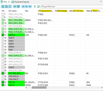

 3. Connections in the Pins view 
The connections of each expansion header/board are also shown as a separate column in the Pins view.  
The fields at processor pin rows that are filled contain a reference to the connector, the pin number and may contain a label specific for the expansion header. For example, P19[4] (A1) connects the processor pin to connector P19, pin number 4, and the label on the expansion header is A1. 
  Figure 10. Expansion headers/boards in the Pins view

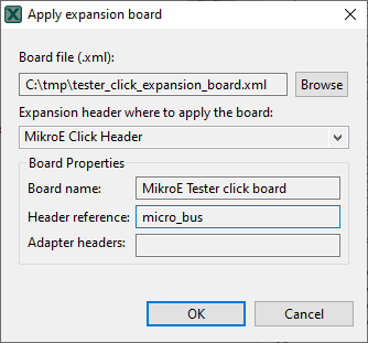

  3.1. Applying/Removing expansion board 
If you have an expansion board definition file, you can apply it to the selected expansion header. After the application, the pins tool suggests routing for all used signals and it is possible to see the usage and corresponding board signals for the expansion board.
The expansion board is distributed as a simple .xml file. The type of expansion header must match the expansion header definition, other headers cannot be used. For details on the expansion board definition file, see the following article: Creating expansion board definition file for Arduino Multifunction shield
To apply an expansion board, use the following steps:
  1. In the expansion header view, select the plus button in the right part of the Expansion Header view toolbar.
    Ana_11-1645126067813.png Figure 12. Expansion board add button
      You can also use the path Main menu Pins > Apply expansion board, where you can choose the expansion header. 
     Figure 13. Apply MikroE Tester click board for a micro bus header type
  2. After clicking OK, the Expansion Board Routing dialog appears
     Figure 14. Expansion board routing open after applying the expansion board

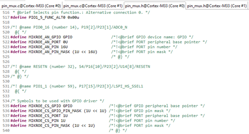

  3. In the dialog box, you can choose which pins function group the routing will be applied to.
    • The routing dialog contains routing tables, where processor pins are pre-autorouted based on the limitations of the expansion board. The routing is validated in real time and can be changed by clicking a cell in the Route column. 

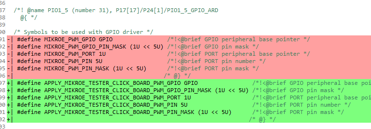

    • You can also decide if and what pin name will be used for the generation of the defined constants in the code for referencing from the application.
        Figure 15. Generated #define for board MIKROE and pins AN, CS
    • The same dialog appears after clicking the edit expansion board in the Expansion header view, but the option to create a new functional group will not be enabled.  Ana_15-1645126067816.png
      Figure 16 Expansion board edit button
 NOTE: Removing expansion board does not remove configured routing. It only changes the identifier defines if they are derived from the board. 
Figure 17. Source code change after removing  the expansion board
