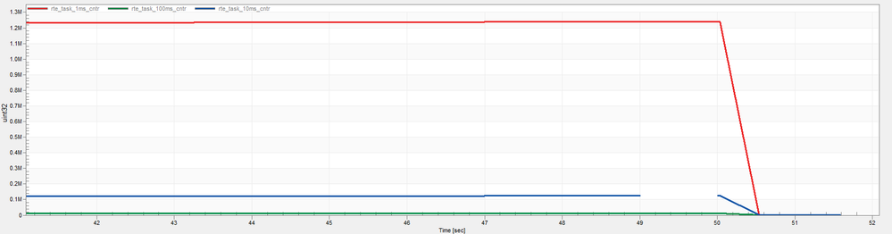

lukas01
The Freemaster communication is operational, as I can successfully ping the ECU. Nevertheless, I'm encountering issues with the transmission of measurements to the GUI. There are instances when certain values are not consistently reported for a period of time.
