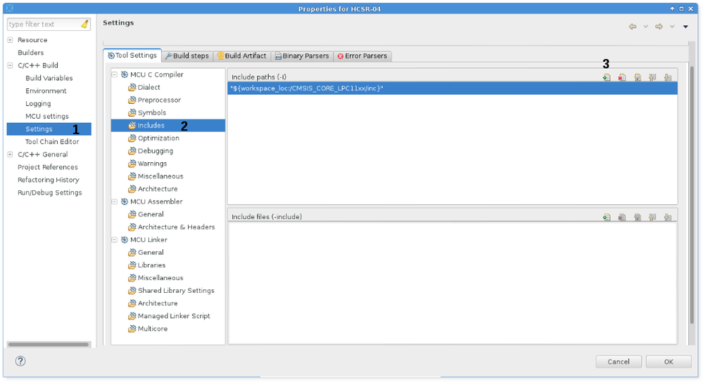

I am trying to learn about the LPC1114, and is therefore using the lpcxpresso.examples.lpc1114.302.zip
I have tried the Blinky and the Uart examples, and both work perfectly, but i would like to combine them.
when trying to combine the two projects, i include the gpio.h and the timer32.h, and include the following lines of code in the main part of the program:
lines of code in main
- init_timer32(0, TIME_INTERVAL);
- enable_timer32(0);
- GPIOInit();
- GPIOSetValue( LED_PORT, LED_BIT, LED_OFF );
Building the program resoults in several errors. The errors are fx. "undefined reference to ´GPIOInit´".
I can see that the drivers for the Uart example hilight the uart.h and uart.c amoungst others, but gpio.h and gpio.c are not highlighted, is this perhaps a part of the problem, and if this is the case how can it be fixed.

I suppose there is a shortage of paths for include in project settings.
You must add path to gpio:
1. Settings
2. includes
3. click symbol Add..
after enter path to gpio.h
