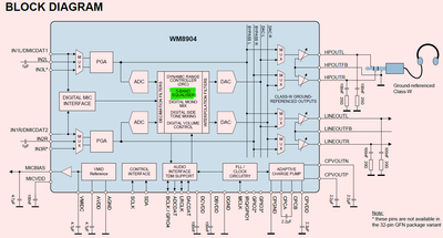

Hi I am using
HARD WARE - 1) lpcxpresso55s16 EVK board ,
                         2) Headset  connected to audio  LINE_OUT of lpcxpresso55s16 EVK board
SOFWARE     - lpcxpresso55s16_i2s_interrupt_transfer(SDK Example code).
audio file transfer to speaker via i2s (interrupt transfer ) but the audio output was totally different.
so please help me to solve this problem.

Hello, I reviewed your information and I noticed at first the audio is too quick at the difference of mp3, so I reduce the clock divider and I checked, the sound is better, could you confirm this?
#define DEMO_I2S_CLOCK_DIVIDER (CLOCK_GetPll0OutFreq() / 48000U / 2U / 2U)
Pavel
12,795 Views
Arularasan
@Pavel_HernandezYes, if we fix the clk divider, we get the rhythm correct, but the problem here is the "tone" is different .
The audio file played in the audio player "TONE"  is not the same when played on our i2s speaker.
Here the problem is "TONE".
I want to increase the base of this tone.
kindly navigate to change the tone.
12,786 Views
Pavel_Hernandez
Hello, sorry for the late response, you need to review the datasheet of the codec WM8904 I suggest reviewing the information that information about the tone.
Pavel
