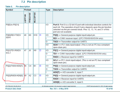

Hi, Thank you for your help. I'm still not able to flash the LPC1769!
- Uart0   →  Checked
P2.10 start low, and in the end, high  →  In normal state this pin is high on my board. I grounded the pin when I pressed the reset button and hoped the ISP mode is ON. Is there a way to control?
-  USB can be detected by PC with a virtual port  →  On the FTDI there is some LED that are blinking during transfert so I think the communication PC ↔ FTDI is ok
But what about the baudrate I need to set?

Q1)P2.10 start low, and in the end, high → In normal state this pin is high on my board. I grounded the pin when I pressed the reset button and hoped the ISP mode is ON. Is there a way to control?
>>>>It is okay to ground the pin P2.10 pin when you press the reset button
>>>The baud rate of uart is 115200. Anyway, pls check if you connect the uart0 pin to the FTDI.

First of all, as you know that you have to use uart0 to download code in ISP mode, the P0.2 is TXD0 pin of uart0, the P0.3 is RXD pin of uart0, pls check if the P0.2/P0.3 pins are connected to the FTDI.
Secondly, pls have uart0 to output character and check if the PC serial tools can receive it or not.

If you want to download application code to on-chip flash of LPC1769, it is okay to use Flashmagic tools to download *.bin in ISP mode.
1)after Reset, the P2.10 pin must be low so that the LPC can enter ISP mode, after you have downloaded the application code, then you have to configure the P2.10 high so that the application code can be executed.
2)you have to use uart0 pin, in detail, P0.2 is TXD0 pin of uart0, the P0.3 is RXD pin  of uart0, the two pins must be connected to the FTDI usb2uart converter.
Pls check if you have connected to uart0 to the FTDI and if the USB can be detected by PC with a virtual port.
Hope it can help you
