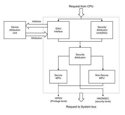

So, when reading its UserManual, there is the following graphic in Chapter 47:
I am assuming that the IDAU interface is defined by ARM themselves, while NXP has to implement the actual IDAU communicating with this interface, which you call DAU here.
The DAU performs a simple and fixed task of splitting addresses above 0x20000000 based on bit 28 into S and NS. Addresses below 0x20000000 are fixed NS when considering the IDAU only.
Does this mean, that the flash addresses -which are below 0x20000000- are split into Secure and Non-Secure only by SAU settings, when leaving all the SECURE_AHB_CONTROLLER settings aside?
I'm asking because in chapter 2.1.3: "TrustZone and system mapping on this device" of UM11126 the flash addresses seem to be fixed S and NS based on bit 28, too.

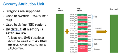

Hello marvin,
"The DAU performs a simple and fixed task of splitting addresses above 0x20000000 based on bit 28 into S and NS. Addresses below 0x20000000 are fixed NS when considering the IDAU only."
->  Yes, below 0x20000000 always NS, above  0x20000000 can config by IDAU. There is some error with
Table 3 of UM.
Please refer to the below picture:
About the detail , please first refer to the demo "Trustzone_example" under SDK , combine with UM.
