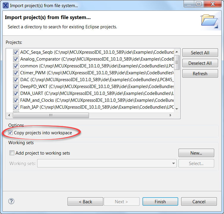

   I have download LPC845 example code from web.
import the projects to MCUXpresso IDE.
it has some project settings are wrong.
something like
PROJECT_LOC/../../Source_Code/GPIO_PatternMatch/docs
have to change to
PROJECT_LOC/docs

Hi Neo,
Please make sure that while importing the examples projects to your workspace the "Copy projects into workspace" option is selected:
Hope it helps!

Hi Carlos,
   yes, I have copy the projects to my workspace.
i think there is something different with OS.
Or the file path is not correct.
I am using macOS.
The file Path is as follow shows.
