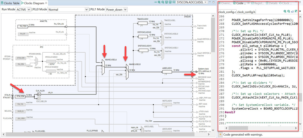

I'd recommend using the clock configuration tool, instead of manually configuring the clock. You may see that regardless of using an external clock to the main clock using the configuration tool, the SystemCoreClockUpdate function is not called to update the SystemCoreClock. Which you are correct if you use it directly then you will be reading the default value which is hard-coded at 16 MHz.
For example, here it is showing 12 MHz from the external clk source, the I selected both MAINCLKSELA and MAINCLKSELB to be from external clock and this is transmitted to my system clock. On the right hand side you will have the code preview of how this is correctly configured and attaches the clocks, the PLL and other peripherals that you may use.
I'd recommend to use the functions in the fsl_clock drivers. If you need to return the core system frequency you may use, CLOCK_GetCoreSysClkFreq.
