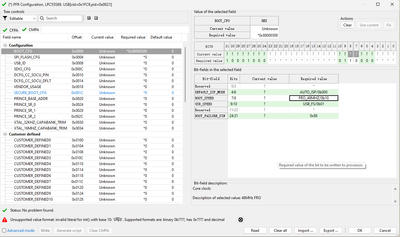

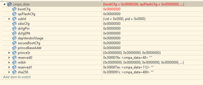

 I could read back both CMPA and CFPA, all zeros inside these structures, then I added codes to program CMPA, the chip bricks. I want the chip be able to boot to ISP with USBFS.
I checked the settings with MCUXpresso secure provisioning, I don't think I setup the wrong boot cfg

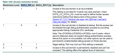

You wrote bootcfg, it may disable ISP.  It's normal you can't work with ISP USB any more.
Please make sure SWD interface is enabled, becuase the only way to re-enable ISP is to mass erase Flash via SWD interface.

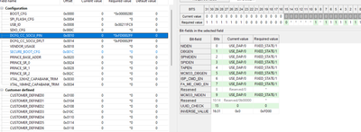

Please make sure you didn't write SOCU_PIN and SOCU_DFLT in cmpa. It they are not 11, SWD disabled. Thus you can't access SWD.
If both ISP and SWD are disabled, and you didn't use debug authentication feature, the part can't be recover any more.

Thanks. My fault, I should notice this inside the datasheet. However, when I read the CMPA back when the chip is in the initial state from whether secure provision program and bootloader inside the chip, it shows 0, which I think should be described more clearly inside the reference manual that if touching the CMPA, user should take care of these registers as well.
Update:
After change SOCU_PIN to 0xfd0002ff and SOCU_DFLT to 0xfd0002ff in CMPA, writing to the CMPA still brick the chip
I only add some codes that change data about CMPA

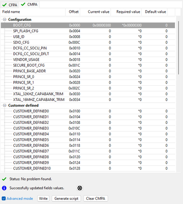

I can use elftosb-gui to provision CMPA and PUF without problem. And then I can use secure provision program to write the bootcfg area, and it works. But I can't change bootcfg using PFR flash api.
And weirdly, I have read what secure provision program had written to CMPA about DCFG_SOC, it is all zero. But it still works.

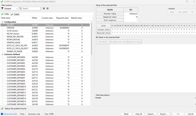

I just used secure provision program to program cfpa only, it still locks me out from debugging and ISP.
Here is the logs from secure provision program:
Write script created: (workspace)/gen_scripts\write_cfpa_win.bat
Executing script C:\Users\liang\secure_provisioning00\gen_scripts\write_cfpa_win.bat
### SCRIPT: Write user configuration to processor: C:\Users\liang\secure_provisioning00\gen_scripts\write_cfpa_win.bat
### Create CFPA page - binary ###

But I want to change the bootcfg to use USB FS for ISP and 96Mhz FRO.
According your description, I setup the CC_SOCU_PIN(9E410) and CC_SOCU_DFLT(9E414) as well in CMPA to try to avoid to brick the chip. However the chip still bricks after writing to CMPA. Cannot boot to ISP anymore. Can you try to write a program to program the chip's CMPA and still leave the debugging enable?
I saw secure provision program will program CFPA when build a sb package. Do I also need to change DCFG_CC_SOCU_NS_PIN(9de20) and DCFG_CC_SOCU_NS_DFLT(9de24) and write them to CFPA?
