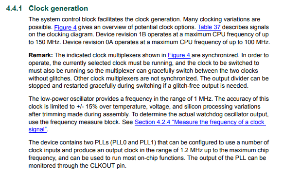

Note: Flash ERASE and PROGRAM operations must be performed with a system clock
below or equal to 100 MHz.
So if I have clock 150 Mhz , I shouldn't erase and program flash memory. Is this so ?
Is exists any examples how-to change MCU clock on fly safetly ?
I assume peripherals clocked from independent clock source  and we should adjust system clock and something else in safe way. How to do this on fly ?

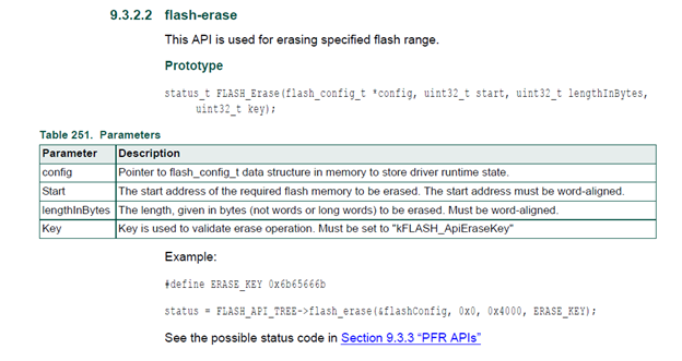

3. If I undestand right and minimal erasable unit of Flash memory is  512 bytes.
  Does exists any other bigger erasable sector ?
Or if I would like to erase 8KB space , erase time will be 16*21ms ?

1.So if I have clock 150 Mhz , I shouldn't erase and program flash memory. Is this so ?
Yes, it is a flash erase/programming constraint to be 100MHz or less for flash/erase operations.
In clock_config.c you can find void BOARD_BootClockPLL150M(void) function which configures system clock to 150 MHz, and void BOARD_BootClockPLL100M(void) which configures system clock to 100 MHZ. Those are example codes already implemented in the clock config. I would recommend to use the power_manager_lpc example provided in the SDK which describes how to change between different clocks.

3. If I undestand right and minimal erasable unit of Flash memory is  512 bytes. Does exists any other bigger erasable sector ? Or if I would like to erase 8KB space , erase time will be 16*21ms ?
The FLASH_Erase function receives a 32bits parameter: lengthInBytes, that is the limit. The only requirements is that must be word-aligned. You can see an example in the User Manual in page 231, where the lengthInBytes parameter is 0x400
Could you please clarify how you are calculating the erase time. The datasheet provides the typical erase time for 1 page(512bytes) which 2ms.

Could you explain tricks what need to update system clock on fly. If we see powermanager example in case of Power-Down:
DEMO_PreLowPower();
POWER_EnterPowerDown(APP_EXCLUDE_FROM_POWERDOWN, 0x7FFF, WAKEUP_GPIO_GLOBALINT0 | WAKEUP_GPIO_GLOBALINT1,1);
DEMO_PowerDownWakeup();
APP_InitWakeupPin();
Looks like after wakeup you switch to FRO12Mhz oscillator and do not return back to 150Mhz.
And it is not so clear if Power-Down mode need if you would like to switch  from 150 to 100 and back.
Or it should be done via FRO12Mhz.
What kind of effect have those pre/wakeup functions for GINT0/1 pin detection ?
What should be really disabled while transistition  of system clock from 100 ->150 -> 100 Mhz ?
I assume peripherals has independent clocks and only MCU need some sequences while systemclock changes.
You need to have both clocks running in order to switch from one to the other.  The following should be considered for the generation of the clocks.
Also, to make it easier you may use the clock tool provided in MCUXpresso IDE. To make the code necessary to use the clock at certain frequencies.
Sabina
