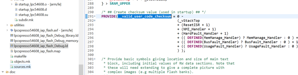

4) In the example project in the lpcxpresso SDKs. Using "Legacy" images, they all run fine. The 8th vector in the table is the 2s compliment of the first 7. But I can not seem to find where that happens? Where is that 8th vector being calculated and put into the image? The binary file does not have it, but once it's programmed on a device it has the right value.

  4. This value is calculated at the Linker Script when you debug your project
Let me know if this is helpful.
