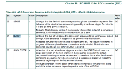

xiangjun_rong
Pls try to set the burst bit in SEQA_CTRL register.
When the clear the burst bit, each software triggering only triggers ADC to sample once, the DMA can only be triggered once, that is why you can NOT get 100 samples, so the DMA never generate interrupt.
Secondly, pls disable ADC interrupt when you use DMA to transfer data.
For the original example, the ADC is triggered by a timer, so the ADC can be triggered multiple times, so the DMA can be triggered multiple times, the example works fine.
Hope it can help you
XiangJun Rong

xiangjun_rong
Yes, I suppose that your code is almost correct, but you have to remain the software trigger line, pls try to use the following lines:
while (1)
/* Get the input from terminal and trigger the converter by software. */
GETCHAR();
ADC_EnableConvSeqABurstMode(ADC0); //burst mode start
ADC_DisableInterrupts(ADC0, kADC_ConvSeqAInterruptEnable); //disable ADC interrupt
g_DmaTransferDoneFlag = false;
ADC_DoSoftwareTriggerConvSeqA(ADC0); /* Trigger the ADC and start the conversion. */

Note that the ADC_DoSoftwareTriggerConvSeqA(ADC0); can start ADC to sample, because you have configured bust mode, so after once software triggering, the ADC will continue to sample one by one.
If the bust mode does not meet your requirement, you can enable a timer, in the ISR of timer, execute the ADC_DoSoftwareTriggerConvSeqA(ADC0); each triggering will launch ADC to sample once. so 100 times software triggering will start ADC to sample 100 times, the DMA will transfer 100 times.
