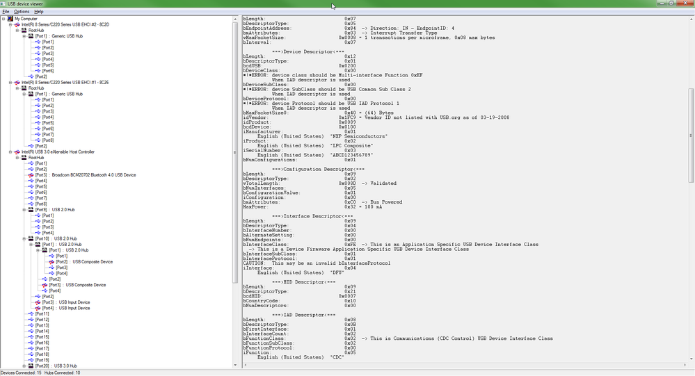

Tried the DFU example (without any modifications) from the file lpcopen_2_20_lpcxpresso_nxp_lpclink2_4370.zip.
We uploaded the DFU example to the flash of the LPC-LINK 2. Then reconnected the USB cable and device shows up the USB composite device as shown below

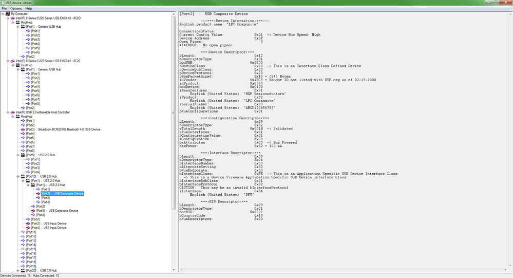

Next the device switches the DFU mode, goes to an alternate configuration of the USB and shows up as

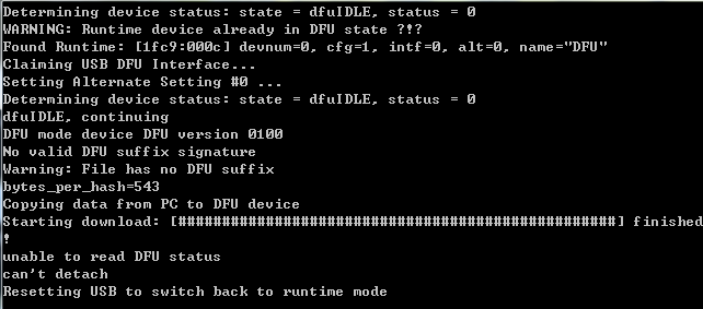

Again we run the command
dfu-util.exe -d 1FC9:89 -c 0 -i 0 -t 2048 -R -D LPCScrypt_140.bin.hdr
dfu-util 0.7
Copyright 2005-2008 Weston Schmidt, Harald Welte and OpenMoko Inc.
Copyright 2010-2012 Tormod Volden and Stefan Schmidt
This program is Free Software and has ABSOLUTELY NO WARRANTY
Please report bugs to [email protected]
Filter on vendor = 0x1fc9 product = 0x0089
Opening DFU capable USB device... ID 1fc9:0089
Run-time device DFU version 0100
Found DFU: [1fc9:0089] devnum=0, cfg=1, intf=0, alt=0, name="DFU"
Claiming USB DFU Interface...
Setting Alternate Setting #0 ...
Determining device status: state = dfuIDLE, status = 0
dfuIDLE, continuing
DFU mode device DFU version 0100
bytes_per_hash=563
Copying data from PC to DFU device
Starting download: [##################################################] finished!
state(2) = dfuIDLE, status(0) = No error condition is present
Done!
Resetting USB to switch back to runtime mode
No valid DFU suffix signature
Warning: File has no DFU suffix
can't detach
And after this, the USB connection is gone, and the device is not responding anymore.

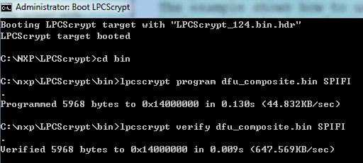

1. Click the Boot LPCScrypt, then program the ufu-composite demo image to SPIFI.
2. Configure MCU boot from the SPIFI when JP1 closed.
But I encountered a weird issue, the PC can't recognize the USB device, and in the readme.text, it states "When connected to Windows host use the .inf included in the project", however I didn't find the inf file.
