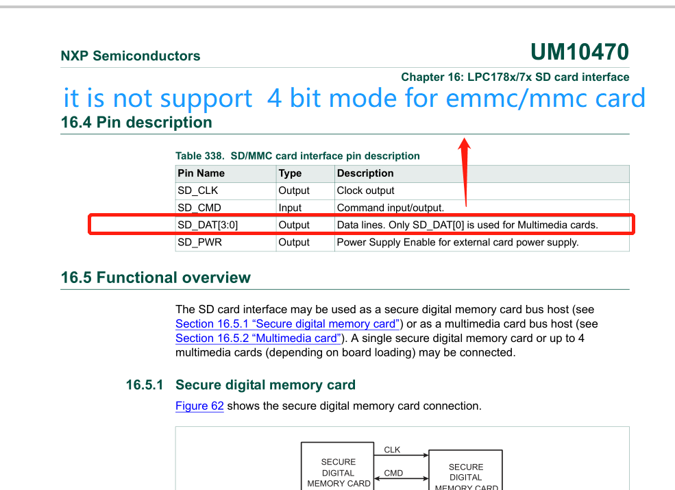

thinkking1985
Why is it not successful to set the bus width to 4bit in MMC mode? Why is it clear in the NXP official routine that the line width below MMC V4 does not support 4bit.

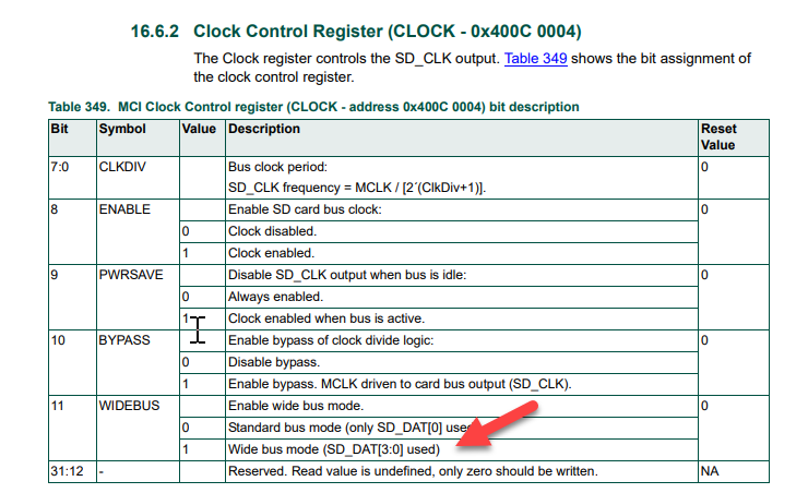

Alexis_A
Dear thinkking1985‌,
Can you let me know where did you find that note? In the RM mention that you would need to enable the WIDEBUS in the CLOCK register:
Alexis Andalon

thinkking1985
Hi Alexis

Alexis_A
Hello Alvin,
You're totally right, the 4-bit support is only for secure digital memory card interfaces.
