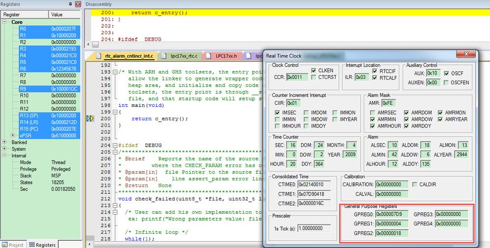

I am facing the same issue with LPC1768 ------> the RTC work fine only with mains power ON,even if coin battery of 3.3v connected to RTC pin.
While initiating the program the backup registers need to be read to load the RTC value. But in my case after resetting the power the backup registers not storing the RTC value.
 suggest whats the solution?

My problem is .. when I reset or power cycle the board ..and try to read the RTC value stored in Backup register..The value either not getting stored in register or RTC is not able to start from the last stored backup value
 Please explain procedure to restart RTC after power cycle or reset..

jeremyzhou
Hi Ajit Kale,
Actually, I'm not very clear with the question, whether you mean that the values will miss in the GPREG0 to GPREG4 register after POR reset.
If not, I was wondering if you can introduce it again.

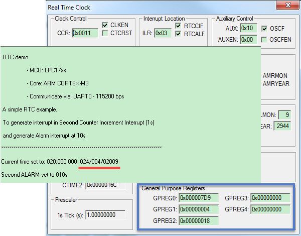

jeremyzhou
Hi Ajit Kale,
Thanks for your reply.
The RTC contains a small set of backup registers (20 bytes) for holding data while the chip is powered off and the backup registers won't store any values automatically, in another word, after POR reset, it should reinitialize the RTC module like before.
Hope this is clear.

ajit_skale
    Correct ! I am doing the same ... writing the Backup register before power off and reading the backup registers after power ON .. also initalizing the RTC value after Power ON.. but RTC not getting initialized .. I tried with several boards... but same result....please clarify

jeremyzhou
Hi Ajit Kale,
I think the root cause is the failure of writing these backup registers, in another word, the backup registers don't contain the expected values.
To confirm it, I'd highly recommend you to share a demo code which replicating this phenomenon, then I can dig much deeper into it.

4,583 Views
jeremyzhou
Hi Ajit Kale,
Your code seems a bit complicated to replicate the phenomenon, so I've used the simple demo for testing.
The following below code is used to get the current time and store these values to General purpose registers.
    // Get and print current time
    RTC_GetFullTime (LPC_RTC, &RTCFullTime);
    _DBG( "Current time set to: ");
    _DBD((RTCFullTime.HOUR)); _DBG (":");
    _DBD ((RTCFullTime.MIN)); _DBG (":");
    _DBD ((RTCFullTime.SEC)); _DBG("  ");
    _DBD ((RTCFullTime.DOM)); _DBG("/");
    _DBD ((RTCFullTime.MONTH)); _DBG("/");
    _DBD16 ((RTCFullTime.YEAR)); _DBG_("");
    // Store the time to General purpose registers
    RTC_WriteGPREG (LPC_RTC, 0, RTCFullTime.YEAR);
    RTC_WriteGPREG (LPC_RTC, 1, RTCFullTime.MONTH);
    RTC_WriteGPREG (LPC_RTC, 2, RTCFullTime.DOM);
    RTC_WriteGPREG (LPC_RTC, 3, RTCFullTime.SEC);
    RTC_WriteGPREG (LPC_RTC, 4, RTCFullTime.MIN);‍‍‍‍‍‍‍‍‍‍‍‍‍‍‍‍‍‍‍‍‍‍‍‍‍‍‍‍‍‍‍‍‍‍‍‍‍‍‍‍‍‍‍‍‍‍‍‍‍‍‍
According to the Fig 1, we can find the storing operation works fine.
Fig 1
After power reset, the General purpose registers still keep the timer values.
Fig 2
After the testing, it shows that the General purpose registers can keep information when the main power supply is off and the value in these registers is not affected by chip reset.
I've attached the complete demo, please refer to it for details and give a try.
