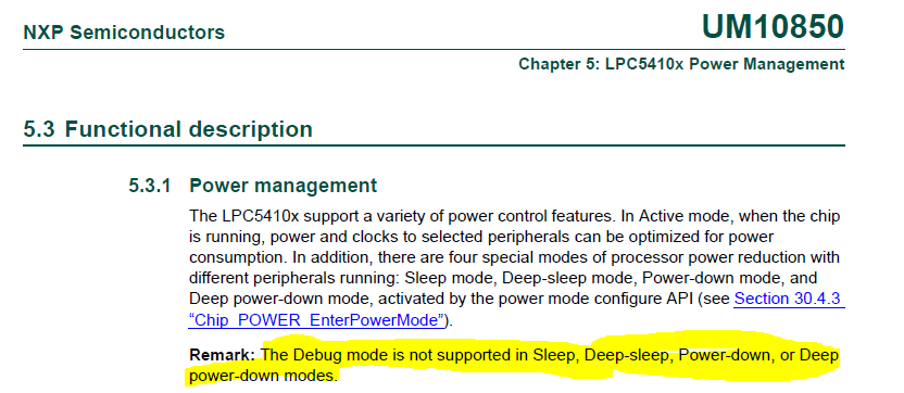

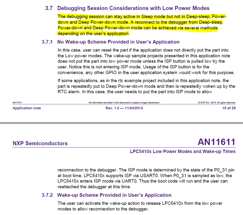

simonwyss
According to the user manual UM10805 Page 80 it is NOT possible to debug the low-power modes. (http://www.nxp.com/docs/en/user-guide/UM10850.pdf )
But in the appnote AN11611 is written that the debugger can be reconnected. However, NXP doesn't write in the appnote, how the reconnection could be accomplished.
NXP, can you give use some advice?

Carlos_Mendoza
Hi Simon,
You should use the "Attach Only" option in the debug configurations, this will allow you to debug a running system:
https://community.nxp.com/message/630604
