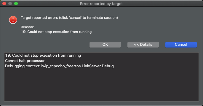

Hi everyone,
I'm trying to connect an mbed NXP LPC1768 in ethernet with FreeRTOS. I'm using MCUXpresso 11.1.2, but I did the same tests with MCUXpresso 10.3.0 and 10.2.1. The operating system that I use is macOS Catalina, but I did a test also with MCUXpresso on Ubuntu 18.04 virtual machine. The firmware of the mbed NXP LPC1768 is the last version (141212) taken from the official Mbed website (os.mbed.com/handbook/Firmware-LPC1768-LPC11U24). The debug configuration that I use is the LinkServer C/C++ (NXP Semiconductors) MCU Application.
Firstly I tried to run some demo projects with an ethernet interaction taken from LPCOpen. All the projects build without errors or warning, but I'm not able to make it works. The freertos_blinky project works well: I can run and debug it. However the periph_ethernet, webserver, webserver_freertos, lwip_tcpecho_freertoslwip_tcpecho_sa and in essence every demo project with an ethernet communication start to run, but when I try to stop or pause the execution this is the message error that I catch and the debug session closes:
Schermata 2020-11-02 alle 22.29.41.pngSchermata 2020-11-02 alle 22.29.41.png
Then if I try to rerun the project the "Cannot halt processor" console error reappeared:
Schermata 2020-11-02 alle 22.43.35.pngSchermata 2020-11-02 alle 22.43.35.png
After this error I become no longer able to test any project on the LPC1768 with MCUXpresso, because if I try to run any project, the "Cannot halt processor" error will return.
The only way to recover the LPC platform is to use MBED Studio to build a .bin execution file, and load it in the device driver of LPC1768. After power-cycle the board by disconnecting and reconnecting the cable, I can still use MCUXpresso to run projects.

After some debugging, I understand that the "Cannot halt processor" error is caused by the Chip_ENET_Init() function call. I have found that the Chip_ENET_Init() problem is already discussed in this post: Ethernet-init-problem-with-LPCopen-and-CMSIS. Therefore check the post for the continuation of the discussion.
